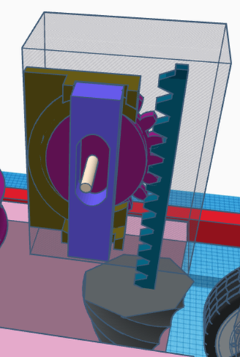

Hi Team,
I just had another question. How can I attach a simple servo motor to rotate a shaft which is connected to a pinion that in turn rotates the rack? The pink is the pinion and the shaft is the beige. The blue is something I've designed for the motor to sit on securely but with your suggestions I can improve it better?
Thank you.
