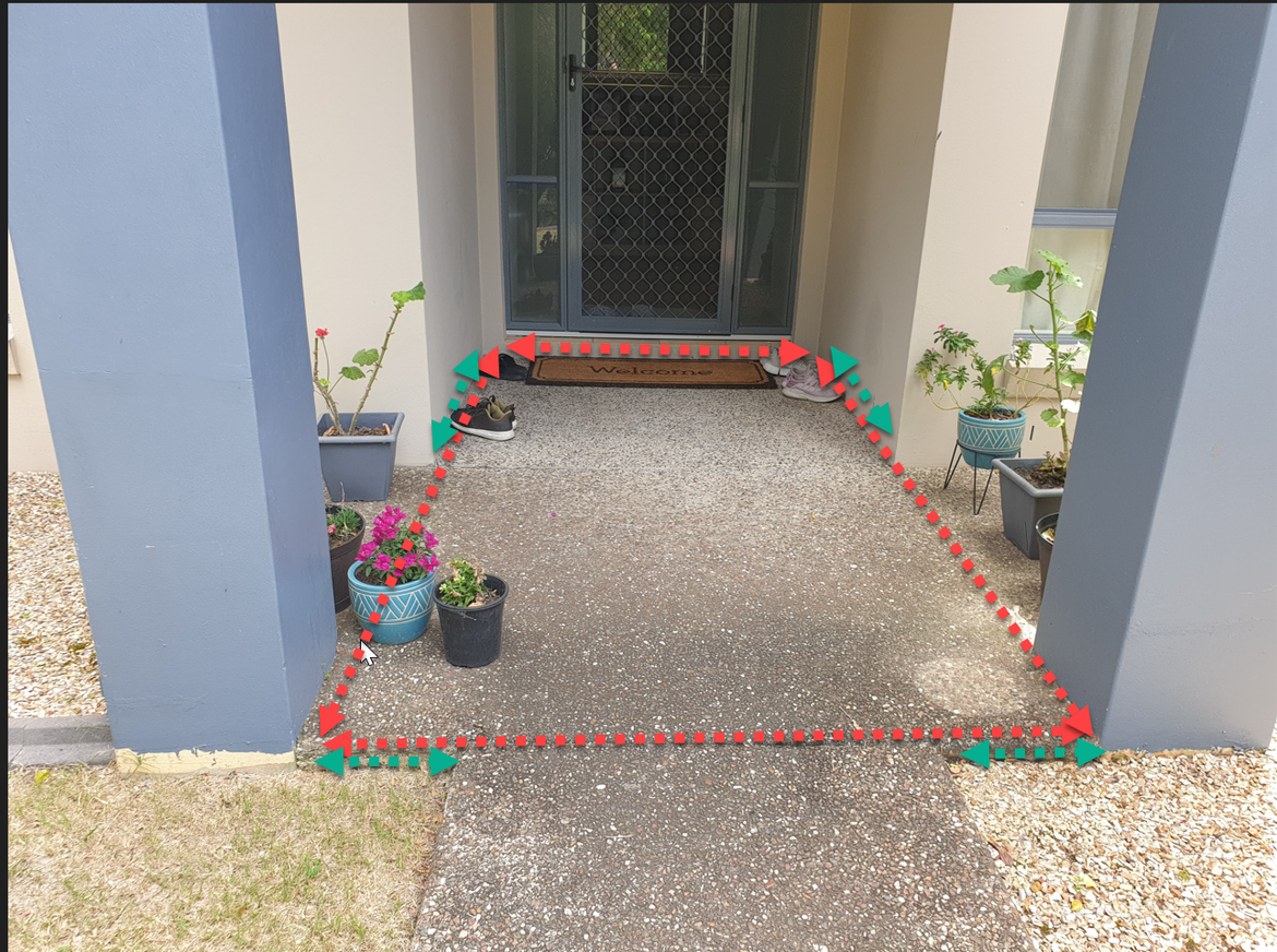

I have added another area (my front area). Please have a look at the picture.
I am going to do tiling in the area indicated by the Red dotted lines. I am a little worried about finishing off the tile here, where two pillars ends ( the dotted line away from the main door). Later I googled and found this:
https://www.nationaltiles.com.au/aluminium-diminishing-trim-robtt370?gclid=CjwKCAjwtKmaBhBMEiwAyINuw...
I would like to create a smooth transition between the tile and the pebblecrete surface so that nobody trips. What is the name of the item we call in Bunnings Store and how to use that during the tiling process where the last tiles end?

3.) I am planning to apply vertical tiles on the areas indicated by the green lines (probably I had already asked this before). Is that a good idea or are there any other alternatives for the vertical section of wall just above the floor ?

Hi @Sugar,
The diminishing tiling trim you're after is manufactured by one of our suppliers, Roberts design. If you speak with one of our helpful team members at your nearest store's Special Orders desk, then we'll be able to order the trim for you.
Here's a helpful step-by-step guide that you should find useful: How to lay floor tiles. I'm sure it will answer many of your questions and give you the confidence needed to start this project.
You'll need to wait for the adhesive to dry before removing the tile spacers. Drying times are dependent on the tile adhesive you choose. Typically, a 24-hour drying time is fairly common. Once the adhesive is dry, you can grout your tiles.
Tiling the verticle sections is certainly an option. An alternative could be to use 42 x 18mm 2.7m FJ Pre Oiled Merbau Screening which might make a nice natural wood highlight to your tiling job.
