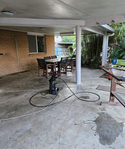

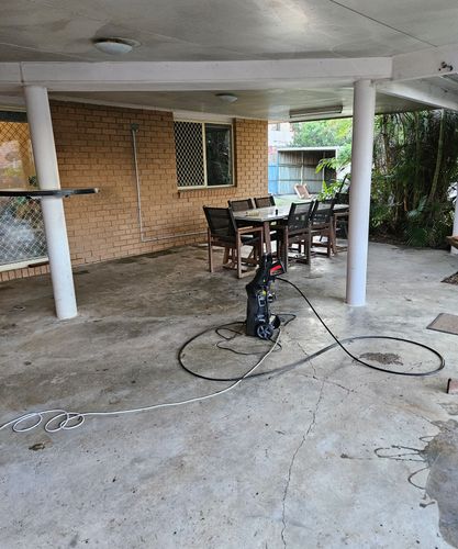

I have an old concrete slab for my outdoor patio that I want to renovate. The slab is level but cracked in a few places. I was thinking of Travertine but then thought maybe this would look ok https://www.bunnings.com.au/brighton-masonry-300-x-300-x-40mm-sand-mypave-paver_p3451558 with the advantage of easily fixable if I mess up because I can just pop in to Bunnings for more. My questions are:
Do you think it will look ok? I had in mind this colour scheme https://www.berger.com.au/inspiration/a-modern-patio-that-shines/?fbclid=IwAR1hfZrxWpG-xLVdlLMh8DO0J...  (my patio is very old fashioned with round columns everywhere)
What would I use to lay the pavers?

I could use the timber from my besser block bench (currently unassembled but ready to go) as barriers to contain the sand as I work through the sections?????
Re: How to lay paving on my patio?
That's entirely a possibility, @lakiita.  However, you might like to do all the screeding back to an area near the backyard. Then, start laying your paving from there back towards the house. Obviously, you'd need a side access on the property to get to the back without walking over the screeding. Working in sections would be fine, especially if the timbers you have are heavy enough to hold back the sand.
