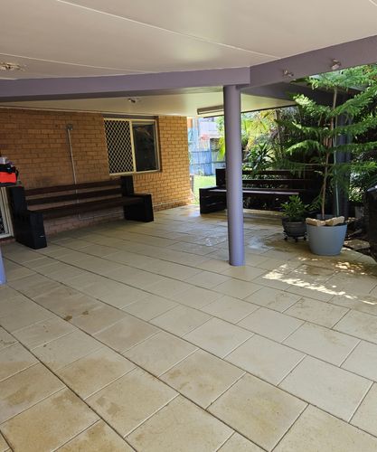

Project is not yet complete. Decided I needed to spend more time washing the surface of the pavers to get polymetric sand dust off before sealing and I won't consider it complete until the sealant is done.

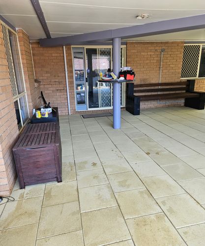

I agree re columns - My Dad's a legend - he did all those and he did it with that monster angle grinder that I could barely lift let alone use. I really have no idea how he did it - he made a template and then did just lots of horizontal cuts until he was happy with it. Definitely beyond my meager skills. However I did all the edges. I'm 9/10 happy with my cutting and 8/10 happy with the laying. Because I haven't laid pavers before I focussed a lot on levelling individual pavers and keeping lines straight not realising that you also have to make sure the pavers are all the same height so there's a little bit of unevenness to the job but I don't think it's enough to trip anyone up so it's not really going to matter and thankfully I'm no perfectionist!! Fingers crossed the weather holds so that I can seal soon!!
My score may go down if I can't get some of this sand residue off I bought some paver cleaner today so just washing and rewashing and won't seal until I'm happy with the result.
Final coat of sealant complete but OMG the smell - its sooooo strong and seems to be getting worse - I hope it fades quickly!!!!

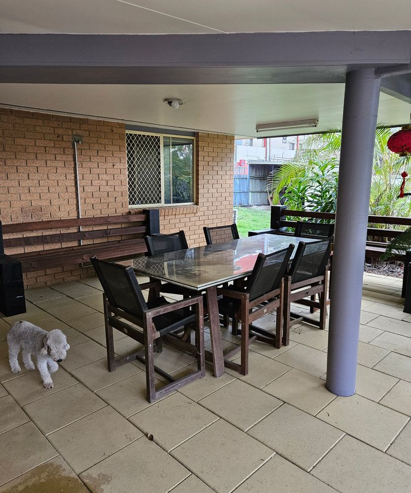

The final result with my Besser Block benches and my renovated epoxy pour resurfaced table (picked up the table for $50 with a scratched black cement type surface) and bonus Bedlington Terrier photo bomb
Hello @lakiita
That paving and furniture combo looks absolutely brilliant!
Thank you so much for sharing such a wonderful project.
