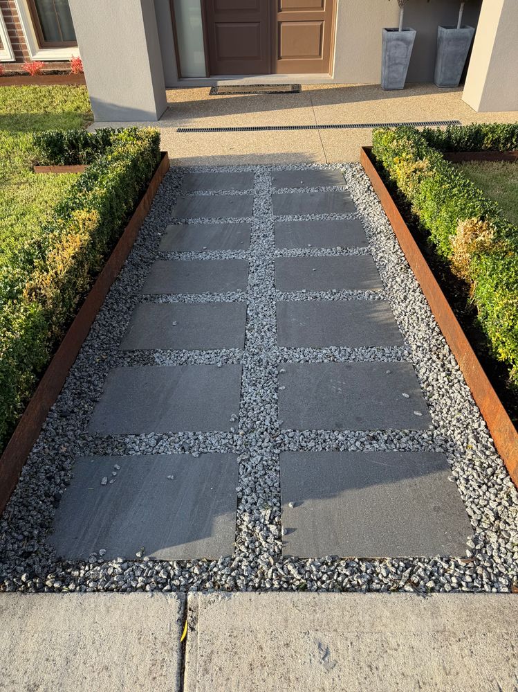

Hi I recently had a landscaper put in pavers but the height of them was only 20mm so I have purchased some that are 40mm and want to lay them on top and want to know what the easiest and best adhesive to use. Please see attached image for the already laid 20mm pavers

You can use Liquid Nails Landscape to adhere the new pavers to the old.
Bear in mind that you are now raising the pavers 40mm above the surrounding pebble surface, which could cause a bit of a trip hazard. Pavers are normally laid flush with or slightly above the surrounding surface.

Thanks for the prompt response Mitchell, the actual pavers are a small step down from the path and I have more pebbles to top it up. Thanks again so much
