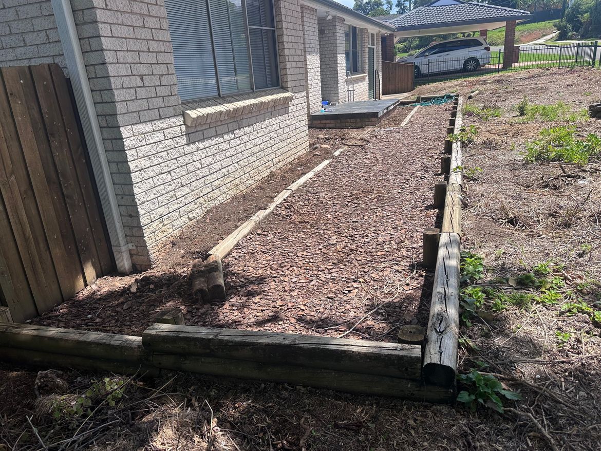

How to lay front yard paving?

If the pavers are evenly spaced there should be no issue with drainage as it will spread out to the side towards your pebbles. But if you are building something like a Paved Pathway, then installing drainage on either side would be necessary. I've placed a photo manipulated sample image below to give you a bit of inspiration in regards to the layout.

To achieve what you have done in the photo, will I need to remove the existing mulch, add road base, paver sand, then pebbles and pavers?

I suggest removing the mulch and re-using it in another section of your garden. I also recommend having a look at this discussion - Travertine pavers and gravel garden path by @TaylerMayd. It's an excellent example of how you can put together the paved walkway with pebbles.
