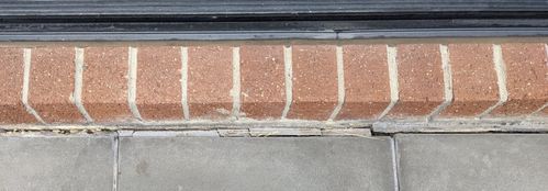

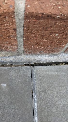

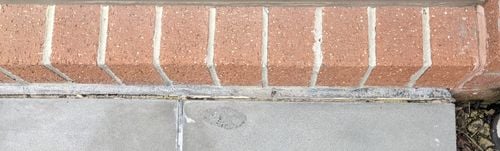

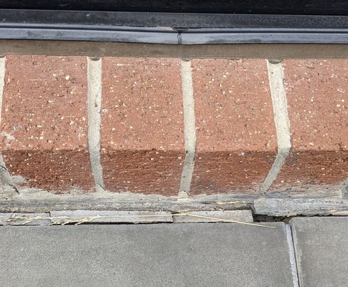

Hi, we would like to repair the gaps between our outdoor bluestone pavers and house bricks. Gaps are about 5mm wide all along the house. The paving was done by landscapers a few years ago; some of the pavers near the bricks are becoming loose as well. What can we use to fill in the gaps, which could hopefully stop the gaps from widening and also stabilise the pavers? Some photos attached - the gaps don't look great! Advice most appreciated, thanks

It appears that the landscapers used some form of grout to go between your pavers and it is now deteriorating. The movement is caused by water entering the gaps and softening the soil base underneath. If enough water enters the gap the sand base that was originally used by the landscapers will get washed away. Which will cause more movement.
Replacing all the grout with Dunlop 5kg Flexible Coloured Grout - Slate Grey or similar, will slow down the movement of the pavers. But it will eventually move again due to the base of the pavers being compromised. If the pavers have been left unattended too long, the sand under the pavers will eventually get washed away by rain.
For a long-term repair, I suggest removing all the pavers and refilling and tamping the sand base of the pavers. You can then re-position the pavers and re-sealing their gap with grout.

One way to mitigate the flow of sand out under your pavers is to put 100 x 16mm 4.8m Edging H4 Treated Pine Sawn Wet on the edge of your pavers. A bit of the soil will need to be dug out so that the edging is at the same level as the pavers. You can also fix them in place using timber steaks or your choice of tent pegs.
In regards to how long the repair will last, I'm afraid only time will tell. Your pavers and the grout are exposed directly to the weather. When the grout starts to deteriorate and allows water to pass through the gap, that is when the movement will start. My best advice is to check the grouts condition yearly, and if it looks like it is starting to fail, that's your signal to change and renew it.
