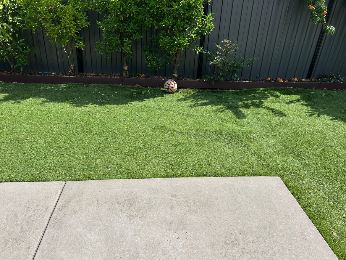

I have synthetic turf in my backyard. The issue is that it has started sagging and became lose. Secondly there are some holes under the turf. Need your help in fixing this issue.

When was the last time you had your artificial turf serviced? It appears that the sand base has been carried away by the rain causing your turf to sag. The holes in your turf are usually patched or taped up. I suggest tracking down the turf clips at the edge of your lawn and pulling them out. I then recommend filling the low areas and dips with sand, you can either use a tamper or a compacter to level the sand base. I suggest using cloth tape to patch the holes from the bottom of the lawn.
Once you've levelled the area you can then cover the sand with your turf and put the lawn clips back into the ground.

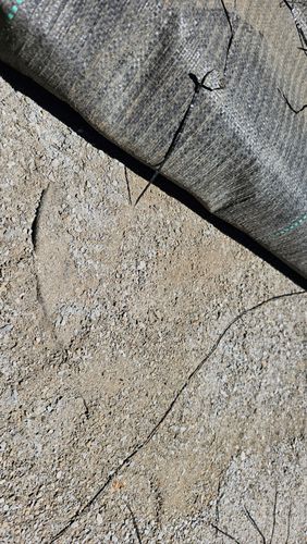

Thanks Eric for the help. The lump in the middle is actually the drain pipe. DO i need to level the soil uptill the height of the pipe or pipe needs to be a bit lower to allow the drainage?
Re: How to fix loose synthetic turf?
Hi @airtel12,
Can you provide some images of the pipe so we have a better idea of what you're working with?
The pipe head is covered with weed sheet with some stone on top of it.
Hi @airtel12,
Is it a small, thin irrigation pipe? If it is just a 19 or 25mm black irrigation pipe, it can be filled over.
It appears that the whole area, which is a couple of square metres, has sunken and needs to be filled up to be level with the surrounding area. I can't imagine this was caused by the pipe or left like this due to it.
