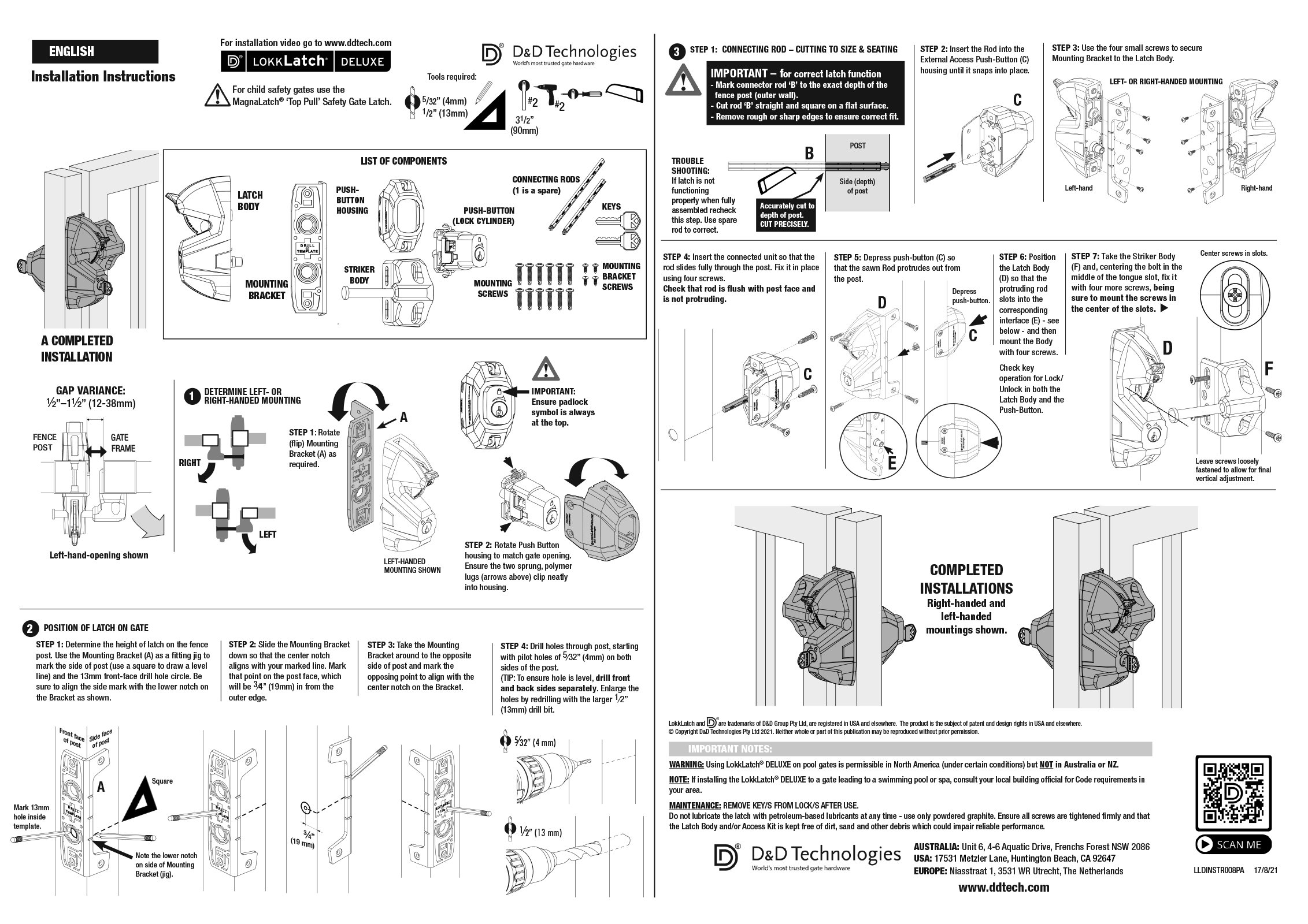

I think I will need https://www.bunnings.com.au/lokklatch-deluxe-s3-gate-latch_p0336015 this one with key holes on both side.
I asked the locksmith to give me a quote for doing this job - $165 call out fee and $125 for the lock….so definitely want to try to do it myself!
Thank you. ^_^
Re: Gate Lock Repair / Replace
Hi @ShirleyL,
That looks like a great replacement as long as your posts and gate are at least 38mm thick.
Having a look at the installation manual, you're going to need a couple of extra tools to accommodate the connecting rods that go through the post. You'll need a drill, a 4mm drill bit, a 13mm drill bit, a phillips bit, a square and a hacksaw.
