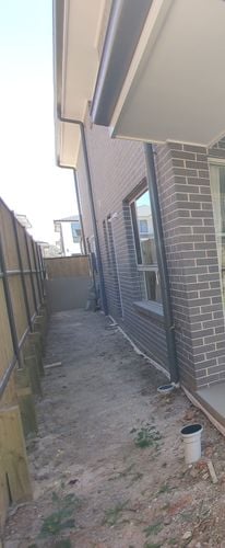

I've recently had the construction of my house completed and now got an empty backyard (full of weeds) which I would like to do its landscaping myself.
I've already killed all the plants/weeds using roundup and I'm planning to dig a trench all round my fence sides and back to place and ag pipe. Unfortunately, when retaining wall was done by a contractor, he advised that ag pipe is not needed but I don't feel that is the case, considering how heavily clay based the soil is.

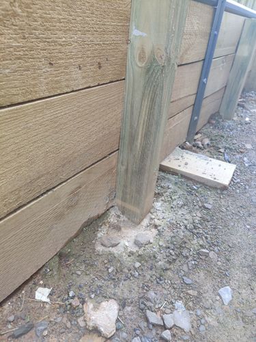

Anyhow, the sleepers are affixed to wooden posts which are set into the ground using cement. I don't know how deep the go.
I would like to dig the trench but I don't know if removing soil from around these posts and retaining wall is a good idea. I'm concerned it might weaken the stability of the wall.
How close to the retaining wall should I dig?

When it comes to digging the trench for the ag pipe, you'll want to be cautious around the retaining wall to avoid compromising its stability. Essentially, the trench should be dug just outside the concrete footers of the posts to ensure you aren’t disturbing the structural integrity of the retaining wall.
The goal is to allow proper drainage while keeping the posts and their cement foundations undisturbed. If you dig too close and expose the footings, you might risk weakening the posts and the overall structure of the wall, especially in clay soil, which can shift over time.
Also, since your soil is heavily clay-based, installing the ag pipe is a wise move to improve drainage and prevent water buildup, which can put pressure on the wall. Make sure to place the ag pipe at the right depth and grade to allow water to flow away from the wall effectively and towards your nearest stormwater pipe. You'll need a licensed drainage expert to make the connection to the stormwater.
If you’re unsure how deep the posts are or how wide the concrete footers extend, it might be worth digging a small test section to get a better idea of their placement before proceeding with the trenching.

Also, forgot to mention, my soil is clay based but very rocky as well full of small and large chunks of rocks, not sure if that would make a difference. I've watered the ground few times and it seems to absorb quite quickly into the ground, I've only seen pooling so far where the retaining wall posts are because of concrete underneath
