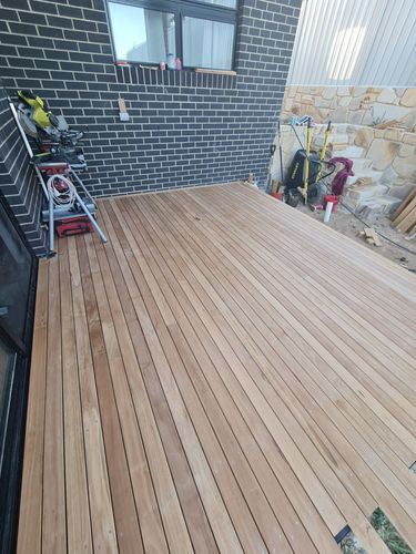

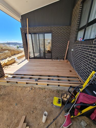

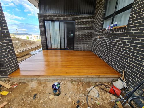

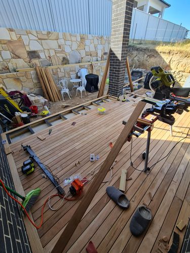

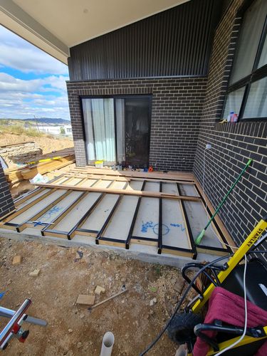

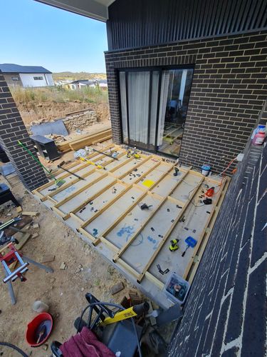

Been very slack with updating on this, finished stage 1 of the deck just in time for Christmas lunch last year. Stage 1 consisted of just the Alfresco area for now as I need some other work done before I could start on the rest as it would just get in the way. Many other landscaping projects going on like moving over 10 cube of soil into my retaining walls etc.
I ended up for the slab using window packers and masonry screws, there is very minimal gap to line up with the back door so to try and lesson the water into the frame painted all cut ends and the bottom of all joists with bitumen paint. Won't make it last forever but the good thing about this side of the house is it gets alot of sun.
Some of the progress photos as I remembered to actually take some.

What timber did you use? Is it Spotted Gum? Whatever it is, its come up a treat!
Great work, and I can't wait to see your next update.
MrSober
Re: How to deck an area of this size to flow from alfresco over the dirt?
The wood I used was Blackbutt, its the second deck I have done out of this wood as I really like the natural colour and how well it holds up. I do prefer a less tinted stain than what I went with as this Intergain one I went for was still a bit red even though I went with the Natural colour.
