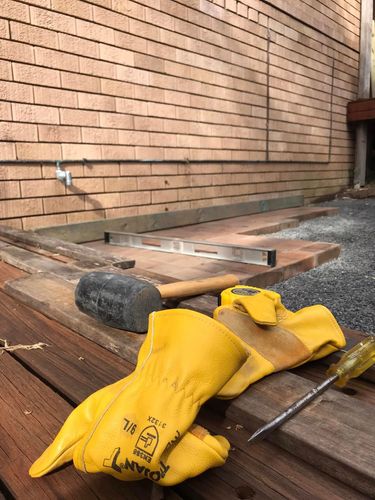

4. What tools would you suggest for this task and is there an instructional video to lay such pavers?
4A - A Rubber mallet, a large flat head screwdriver, gloves and safety specs. (So easy to do)
I havnt put a project together yet for the paving I am doing for my spa but here are a few pics from the laying of pavers.
General area I was paving. I used gravel as I wanted a very free drainage and have found it works well. For you I would use paving sand as its only a small path and will be low on traffic plus who wants gravel in the garden beds!
Main tool I used. Note paver sitting 5mm high
Place one hand this end of paver and belt the other end, then switch ends and repeat. The paver will align itself nicely once it hits that sweet spot
By holding the paver (on the left side for this shot, just push down gently) you stop vibrations tthat happen when you tap the paver that will walk the paver out of true
Sweet spot ohhhh yeah
The tools I used And yep I did take these photos to put a project together
(You should as well as it would be a nice way to duccument your project and also show how it is done!)
