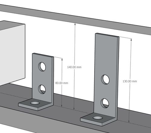

With respect to angle brackets for 120x45 joists, are 40x40x80 OK?  Or should I go a little taller?
Re: Deck options
Hi @IronStan001,
You want the fixing to be roughly halfway up the joist. If you can use a bracket where two fixings can be placed in the joist, all the better. Just be careful with the 130mm. If you have any less than 10mm under the joist, the top of the bracket will be proud and prevent you from attaching the decking.
I think the 80mm bracket will be fine, but you might like to increase it to the 100mm.
MItchell
Re: Deck options
I have 140mm to play with.  120mm of that is taken up by joist with a 20mm airgap.  Looking at some of the brackets, regardless of what size I go (80, 100 or 130), I'd only be able to use the top hole anyway.  I sort of difficult to tell from the picture of the Dunnings brackets the actual difference between the 80 and 100mm brackets, with respect to the location of the holes.  I think I could do 130, but it doesn't leave much room, so I'll go with the 100mm instead of the 80.2024-01-16_13-06-50.jpg
