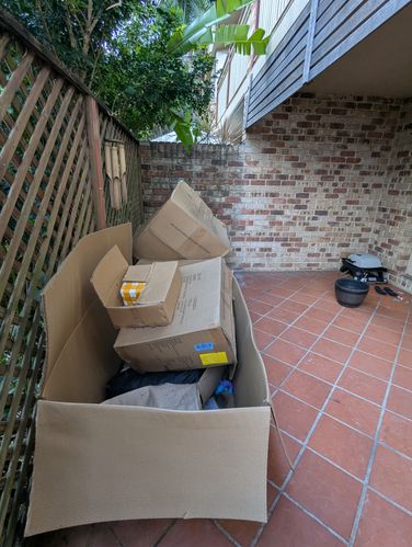

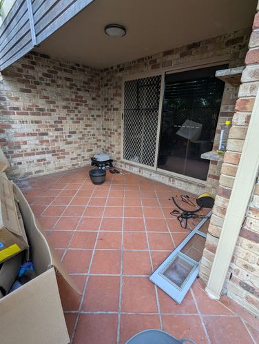

Hi There I would like to turn my patio into a Catio but I don't know where to start, I have no building experience at all, I've also got to make it possum proof as I have a few possum pest that keeps hanging around.
in the photo on the left I'll need to add a door but I want to build it so the sliding door opens up into the cat play area

We'll have to fully enclose the space, so some photos that show all possible entry and exit points would certainly help.
What is on the left? What is behind where the photo was taken?

Yeah I am waiting on a few more pics a swell Good news is its doable
Making it possum proof, that may require a few revisits of th design until its solid.

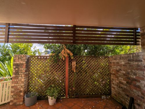

Straight up Im thinking of the Bird Netting to go from the top of the outside of those timber slats down to the top of your trellis.
Coolaroo Shell Timber Fasteners - 50 Pack can be used to fasten the netting to the timber.
The over hang can be attached to the top side of the wall via a piece of timber with some screws through it into the brickwork.
Ramset 7.5 x 80mm Galvanised Masonry Anchor Screw - 100 Box (Note this is a 100box, there are smaller quantites but works out dearer)
70 x 35mm Outdoor Framing H3 Treated Pine - 2.4m is for the top bar along the brick wall. You could also use the same type of timber across the trellis to wedge the netting into.
Doorways to consider factoring in Pillar 90 x 200cm Black Magnetic Strip Flyscreen Door Curtain I am hopping there is a post somewhere to the left as a solid edge for part of the door.
Will wait for pic for the last unseen areas.

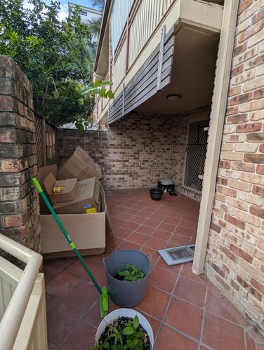

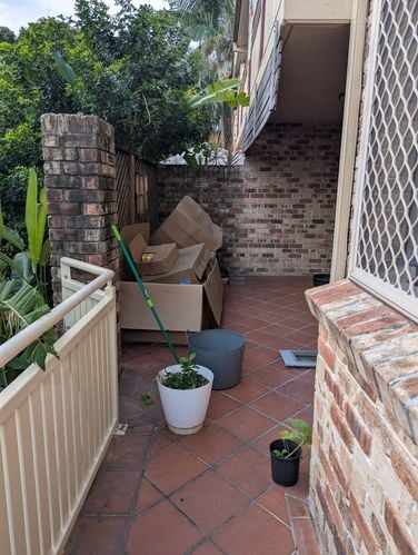

Its part of the balcony there's a tap there no way up or down
Re: How to build a catio?
Indeed @catmom a self supporting box frame (with accommodation for a door) could be made to enclose where the balcony begins to open up, smaller slats to those already employed on your home would tie in with the overall appearance, if this is intended as an all weather area for your cats laserlite UV sheeting would permit sunlight & redirect rain to maximise their space usability.

Thank you for the extra photos, The net design I was outlining would work with that type of screen door I linked. You could attach a vertical piece of timber to the edge of the wall near those wooden shelves and that would give you a hard edge for one side of teh magnet screen. A Rope or timber piece from the top of the horizontal slats down to teh brickwork would enable the mesh to be hung over it. You could have some weights (timber/bessa blocks) across the ground to form a hard edge.
