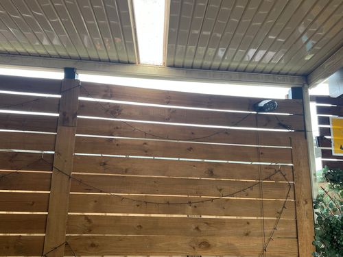

Hi yes here’s a photo of what I’m looking to do so between the 2 black posts is where I wanted to put a cross beam so I can attach something as that’s where the rain gets through and wind I want to try and block that out as much as I can and continue it along between other posts I have already up is it possible?

Please let me know if I'm looking at your posts incorrectly. It appears that they are timber, if they are, why not just install another paling panel across the gap to prevent rain from coming through. Is there a specific reason you wish to install a 70x35. If you are attaching it to the posts, Jacob's suggestion of using triple grips should work in this situation.

Hi, Yes the posts are timber and the pailings are losing their shape and have bode so I’m getting rid of the top half of them, the reason I wanted to use 70x35 is I want to attach a blind from the top and go down to about just past the top of my fence and another reason why I’m getting rid of half the pailings is when we get bad windy and rainy days the water drips through the gaps and onto the deck leaving puddles on the deck

Triple grips will work in this situation.
You can attach them to the post with Pryda Timber Connector Nails 35 x 3.15mm and then attach the timber to them with the same nails.
