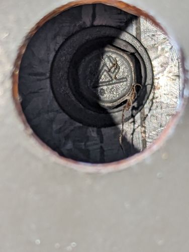

Ideal position of Dynabolt is shown in below picture. One from top view and another from side view.
Should Dynabolt hold well to bricks ?
Re: Side Door
Oops, I didn't look close enough.... I thought it was a wooden post when I said I didn't think that they were long enough.
You are correct for a steel post in which you are attaching it to the back wall of the post via a large hole.
I hope you will be using the Dynabolts with a nut and washer though.
The countersunk head will create a weakness in the hole in the steel, which you don't need to introduce, given that this post is taking the weight of the door. (Unless I am seeing that incorrectly.)
if you use a number of dynabolts (I'd be using at least 3, they aren't expensive)  they will spread the load ok and not pull through the bricks.
A gate or a door presents a dynamic load - it shifts around as the door swings and has to withstand vibrations when the door is shut. If you don't clamp the post firmly to the wall those varying, twisting, loads will work the attachments loose in time.
I didn't fully understand the issue re transferring the holes, but if it is about getting the front and back hole to be the same, use a centre punch through the larger hole to get a mark in the steel for the drill to centre on.
If the issue is transferring the centre of the hole in the steel to the brick wall, drill a smaller hole in the steel than you need for the dynabolt  - big enough to just accommodate the smallest masonry bit that you have, then with the post in place, drill a pilot hole into the brick. This will start your larger masonry bit in the correct place.  Then drill out the steel to the correct size, (away from the wall) which will be the same size bit as the masonry bit needs to be.
You can then drill the hole into the brick before attaching the pole.   (If' I've misunderstood the problem -  ignore the above.)

Hi @nagumuthu , yes, the countersunk dynabolts are best suited to timber posts, where the countersunk head will give a flush finish to the post so it doesn't get in the way of a gate, etc.    You can insert the dynabolt into the post with the nut already on, so it shouldn't drop down.
To get the centre of the other side hole, put the drill bit through the hole you already have and keep it straight while turning it a few times.
That will mark the centre. Then continue with the bit of the size you want.
If you would rather drill from the other side, use a small bit that is long enough to drill right through via the large hole, then turn the post over, using that small hole as the centre for the correct size bit.
Another alternative is to use a square and a pencil and transfer the centre of the large hole around the post by marking a line right around it.
That may not be as accurate if the post edges are not square and straight, but probably good enough for this task since the nut driver doesn't have to be perfectly straight to tighten the dynabolts.
You should be ok using a large, thick washer to fill in the gap for oversize hole that you accidentally drilled.  The post will be kept at the right height by other means so the dynabolt just has to push it back against the wall, meaning the possibility of some sideways movement of the dynabolt within the oversize hole isn't going to be a problem.

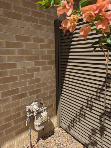

Side gate looking very good @Neo19.
Thanks for sharing.

Hello @Neo19
Thank you very much for sharing photos of your side gate. It looks very well anchored, and those four mounting points will keep it very secure.
