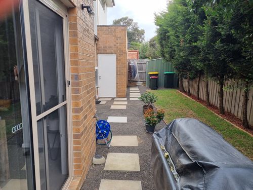

I want to make a timber decking floor for my outdoor area , this is 3mt x 6mt
And I have to make it it 2 sections , both 3x3 to gain access to a drain if need be ,, all advise is welcome, from start to finish

A sketched plan is going to be the first step in your build. Take the measurements off your house and transfer them to paper. You can then map out your deck perimeter. You'll then need to decide which way you'll run your decking as the joist direction will need to be orientated to suit. Working height also needs to be considered. What's yours? Working height is the measurement from the ground to flush with your door sill. It doesn't appear that you have much height to build your deck from the images. Our members often use timber like 90 x 45mm H3 treated Pine when building in a limited space.
Please upload a copy of your planned layout, and our knowledgeable members will be able to have a look over it for you. Don't be overly concerned about access to the drain. I reckon we can come up with a neat little trapdoor in the deck to solve that issue.
