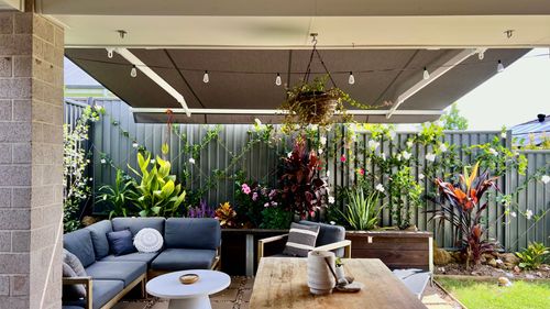

One year later and it’s amazing how much a space can transform! The plants are thriving and we’ve added an awning along with some furniture (a couple pieces from the Bunnings cement/polystone outdoor section) Ready for summer😎

It really is incredible how a year can change a space. The plants have grown, the furniture has been updated and I'm sure many memories have been made.
The awning looks like a great addition to make it that little bit more comfortable.
