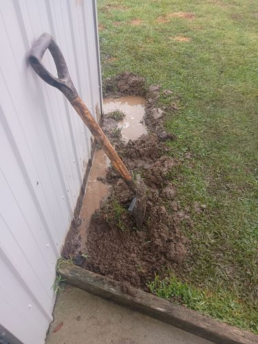

Hi all,

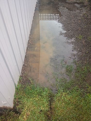

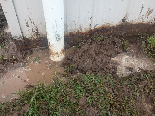

Recently moved to a new property and the shed slab has either sunk over time and the grass has raised.
The shed floods in heavy rain and where the colour bond meets the grass has rusted.

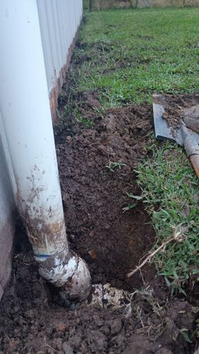

I have started to dig a trench to make a French drain as the water is pooling very bad and entering the shed.
The shed has down pipes that run to the house downpipes and into the water tank. I don't think it will be a good idea to run the flooded water into this system.
Could I get away with a French drain with no outlet ? Plan to use 10mm bluestone, corrugated socked 100mm piping and geotextiles matting and about 200mm deep.
Appreciate any guidance with my first new project. I should mention I do not have the ability to connect the French drain into the normal storm water piping due to retaining walls and other landscape.

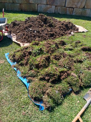

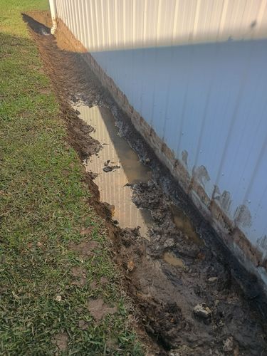

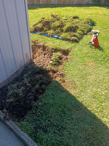

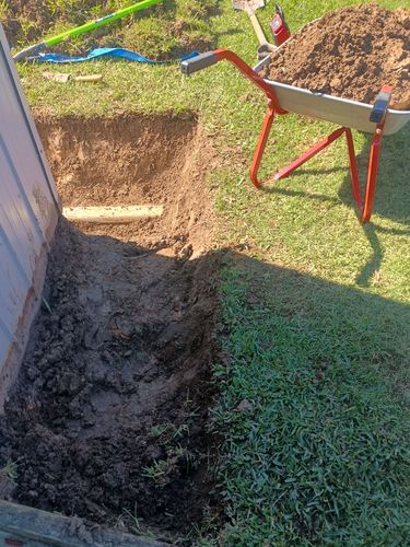

Thanks Jacob. I have started to dig the trench 600x600 , I have the geotextile fabric to line and pegs to hold in place.
I have done some measurements at 8m long around the shed and 600 x 600 I will require approx 3 cubic metres / 3 tonne off 20mm arragate gravel. Does this seem correct?
Some more photos for anyone with the same problem to track my progress.

Hi @fitzy87,
Great work with the digging so far, I'm sure you've had quite the workout.
My calculations also come out to roughly 3 cubic metres.
Thank you for the update.
