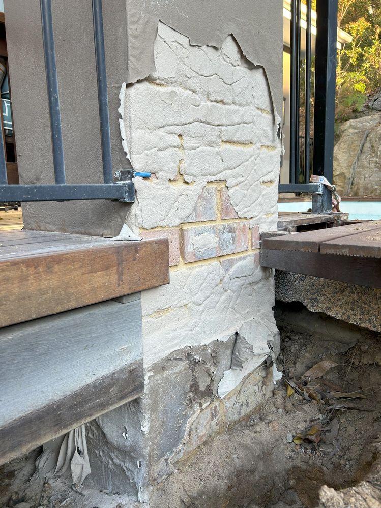

After I raised the level of soil against this pillar, over time the plaster was damaged by the damp.
In future I will keep the soil away from touching the wall, which should prevent it happening again, but what do I need to do to repair the existing damage?
As you can see from the photo, some of the plaster has completely dissolved.

You'll need to start by removing the damaged render and paint from the bricks. This can be done with a brick bolster and club hammer. Anything that is powdery or not attached well needs to be removed.
Once you are back to a brick surface, you can apply Dunlop 20kg Multipurpose Acrylic Render to it. Here's a helpful guide: How to render.
After the render has dried, you'll need to prime it and coat it with an exterior weather-resistant paint.
