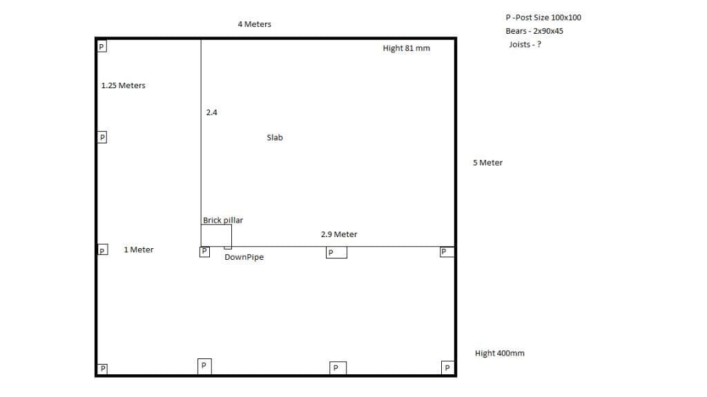

I am looking for some advise on installing my new deck.
The main two problems I have are the height on the slab I have only 81 mm and the downpipe.
I am wanting to do a picture frame but don't know the best way to support the deck around the down pipe.
Also I not sure on what size wood to use on the slab as I have limited space. The broad I will be using is ekodeck.
I have upload my plan on my placement of post. If anyone has some ideas that would be awesome.

With usable space of 81mm less the thickness of an Ekodeck Composite Decking which is 23mm. That will leave us a space of 58mm. If we were to leave an air gap of 8mm, that would leave us with 50mm. In these situations, I recommend using a Steel-Deck Frame. I suggest bringing the plan with you and ask the Special Orders Desk of your local store for a quote on just the slab area.
You can indicate the current conditions of the site such as the downpipe so that the engineers at Steel-Deck can accommodate it in their design. It sounds like an interesting project, any updates you can provide while building it would be much appreciated.

I think @EricL's suggestion of the steel deck is definitely worth exploring, as it will take a lot of the stress over desiging a strong enough deck while navigating limited space. A 58mm gap (after board thickness) is quite small to be trying to build a timber framed deck with adequate ventilation, as ideally you would be using 70 x 45 mm timber (installed to be 70mm high) at a minimum, with 90 x 45mm preferred.
In terms of supporting a deck around a downpipe, Bunnings team member @MitchellMc has provided a handy diagram for how to do exactly that in this post from the workshop community. Essentially you need to frame around the downpipe by running timbers between the joists around the pipe so that extra joists can be then connected in to these supports. However if you go down the steel deck path this should be able to be incorporated into the design, and not something you woud need to do for yourself.

It seems that Steel-Deck does not have anything that goes that low.
Hello @blade_666
I'm sorry to hear that you could not get the size you needed in the Steel Deck range. I have searched in the Good Times Frame Modules as well, but none of them has the necessary depth for your project. Let me make a few enquiries and see if I can find an alternative solution to your decking frame.

You'll find local decking and/or aluminium suppliers will be able to supply you with 40x40x3mm tube which you can then pack up to achieve your desired height.
If you're in Perth, WA I can help you out.

Could I go 50x50x3mm then I will not have to pack it as high.
Also what would be the best way to join them together as I don't have a TIG.
