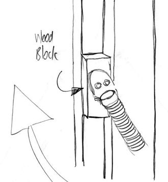

"Alas, the gate is not flush with the front of the post"
A Sunday morning thought - after two cups of coffee - what about putting a block of wood in a strategic position, so that it becomes flush?

Early good morning Offcut! @Offcut 😊
You said...
"it's swinging in the wind"
Which to me means no resistance in the hinges nor are they outta alignment.
You said...
"Your arrow is pointing to the holes on the gate that the spring attaches too"
Which confirms to me again - you have the tension spring on the wrong side of the gate. I don't know what happened in the past - but that make of spring needs to PUSH from the opposite side of the gate. I know you mentioned the post and gate frame aren't flush on the other side - but we therefore need to make it so. See my amateur diagram above.

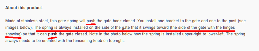

Also, see here...
And from an American web site that does a better job than me in describing your situation, in words...
https://shop.360yardware.com/stainless-steel-heavy-duty-brutus-adjustable-tension-gate-spring-4612-h...
