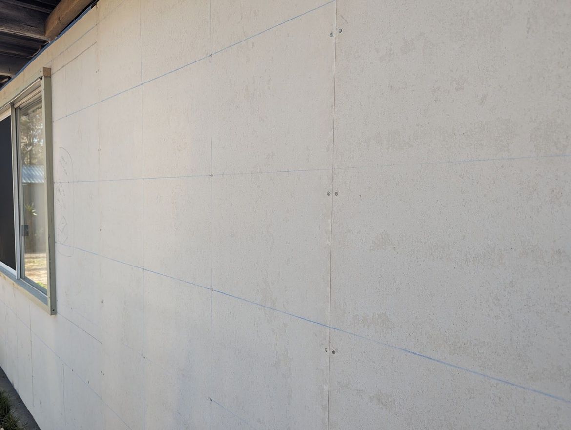

External cement sheets with a filler instead of battens?
Our builders are cladding up an area under a side pergola using cement sheets. They are installed, and they are about to cover the joints of the sheets with thin wooden battens. I would prefer a smooth wall look (without the battens) and wondering if there is a product that could be used to seamlessly fill the joins. The sheets are not recessed for seamless joins, but entirely flat. The joins are generally tight.
The wall is in full sun in the afternoons.

"cover the joints of the sheets with thin wooden battens."
What size battens are they recommending?

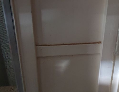

Looking at the completed job above it would be certainly too late for the Brutus Mouldings, which with my house have degraded in the harsh western facing areas. Over time (admittedly 30 years) they became warped, brittle and shatter at the slightest bump.
Other parts of the house have a 40mm plastic batten that is nailed to both sides of the join - they have proved to be very resilient to the weather and time. But I don't know if they're still available?
Either way, I would be going with some sort of batten.
Cheers.
Please excuse the dust.
40 mm Plastic Batten

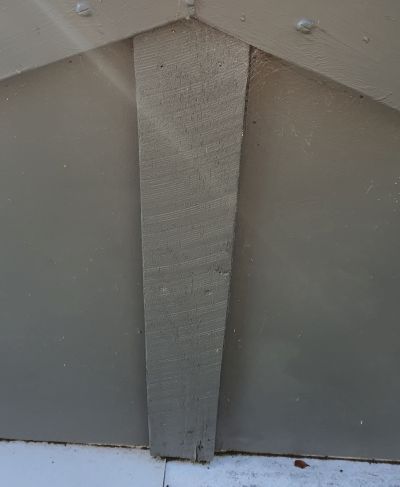

Re: External Cement Sheets with a filler instead of cover strips?
Part or a shed built 30 years ago where the Brutus Moulding (facing west) shattered over time, I replaced with a large hardwood batten. I noticed it too, is starting to crack.
Splitting at the bottom.

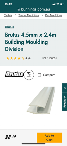

I'm not sure how thick your plastic batten is @Noyade, but we have the Brutus 50 x 6mm x 2.4m Building Moulding Cover Trim.
