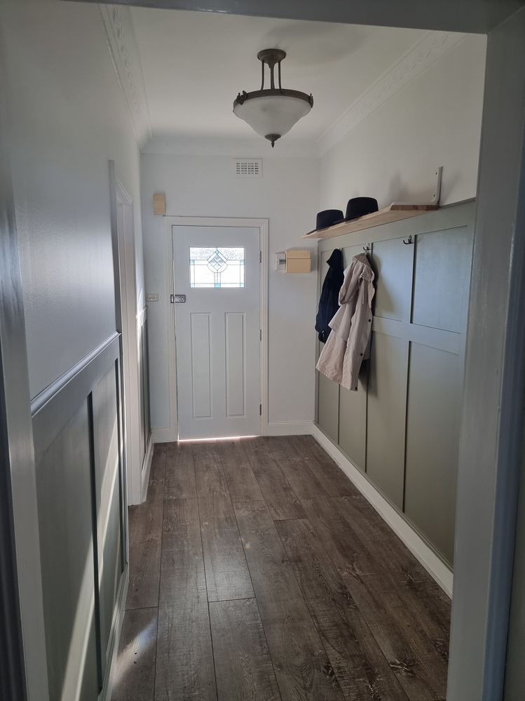

MDF panels, moulding and fresh paint used to create feature walls in a home entryway.
The project
We have recently moved into our home which was built in the early 1950s and found there is much work to be done. We decided to start with a fun project to get us motivated and what better way than to add some features and paint. The entire project took us roughly three weekends to complete, as this extends the entire length from our front door to our dining/living area.

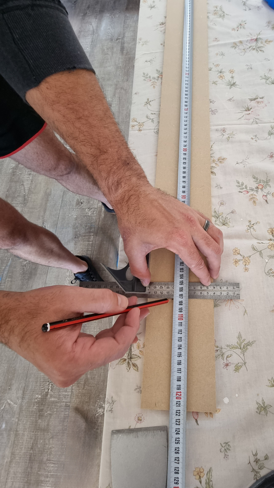

Cut the MDF to the length and width for your desired look. We decided to have our battens 100mm wide and a total height of 1330mm. We wanted to make sure that it didn't interfere with the light switches.
The length of each board was roughly 1060mm, however, there were some adjustments to be made due to our uneven walls. The top horizontal batten was measured to fit the length of the wall. This occasionally meant using more than one board.

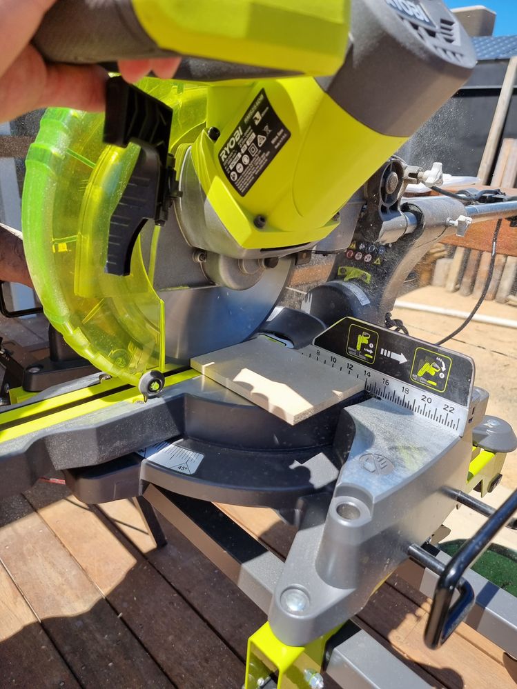

On the right hand side of the entrance door, we decided to add in coat hooks and a shelf, so we extended the height to a total of 1910mm. We used a circular saw for the longer cuts and mitre saw for the short. Don't forget your PPE (safety goggles and ear plugs) for this step.
Husband's helping hands to measure twice before cutting.

Using a mitre saw to cut the lengths.

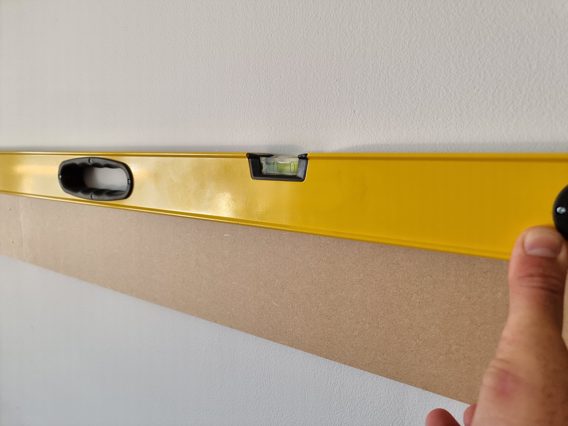

Attach the horizontal battens to the wall. We used a nail gun but you can use a hammer and nails, although this increases the size of your gaps to fill later. Ensure they are level and aligned with the marked height of the battens. You can use a stud finder to nail them into the wall studs for added stability.
Double checking the level.

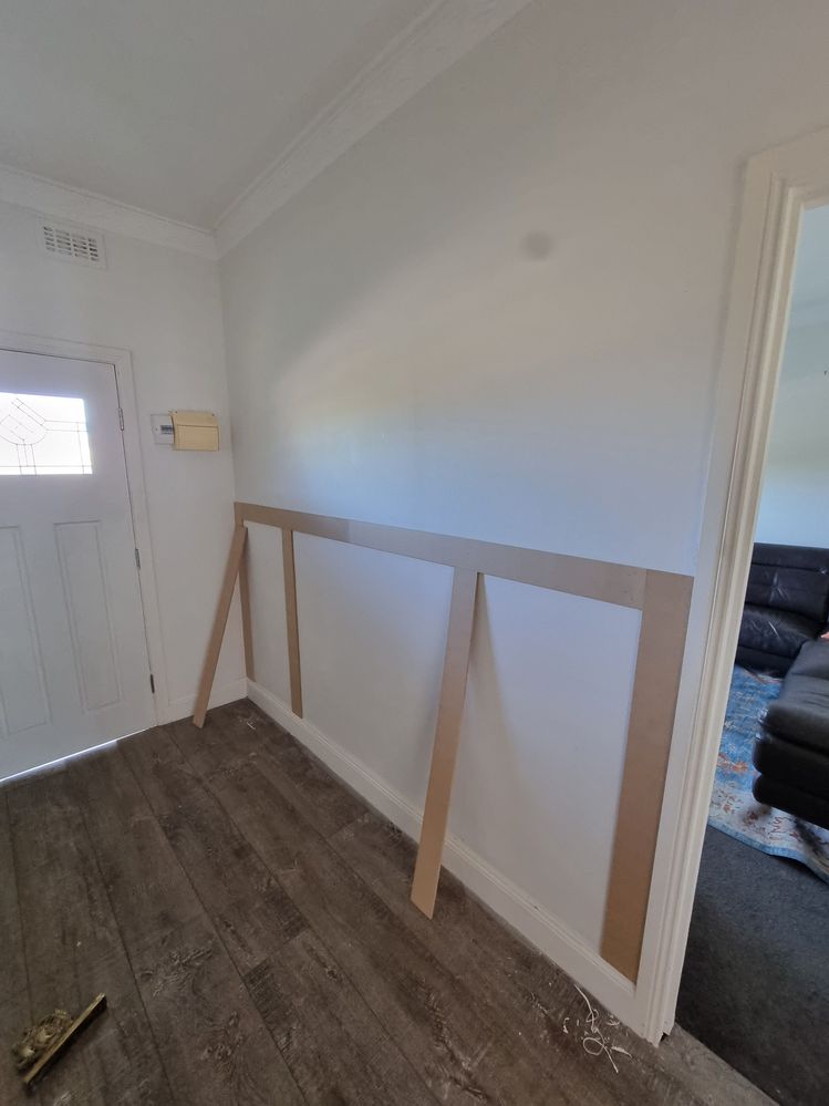

Align your vertical battens against the pre-spaced marks on your wall. We made sure to double check the spacing along the way. Secure the battens to the wall using a nail gun or hammer and nails.
Spacing of the battens.
Secured vertical battens.

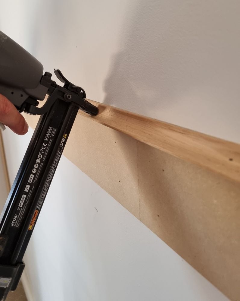

Cut and measure your trim to fit along the top of your horizontal batten. Use a nail gun or liquid nails to attach.
Using a nail gun to secure trim to wall.

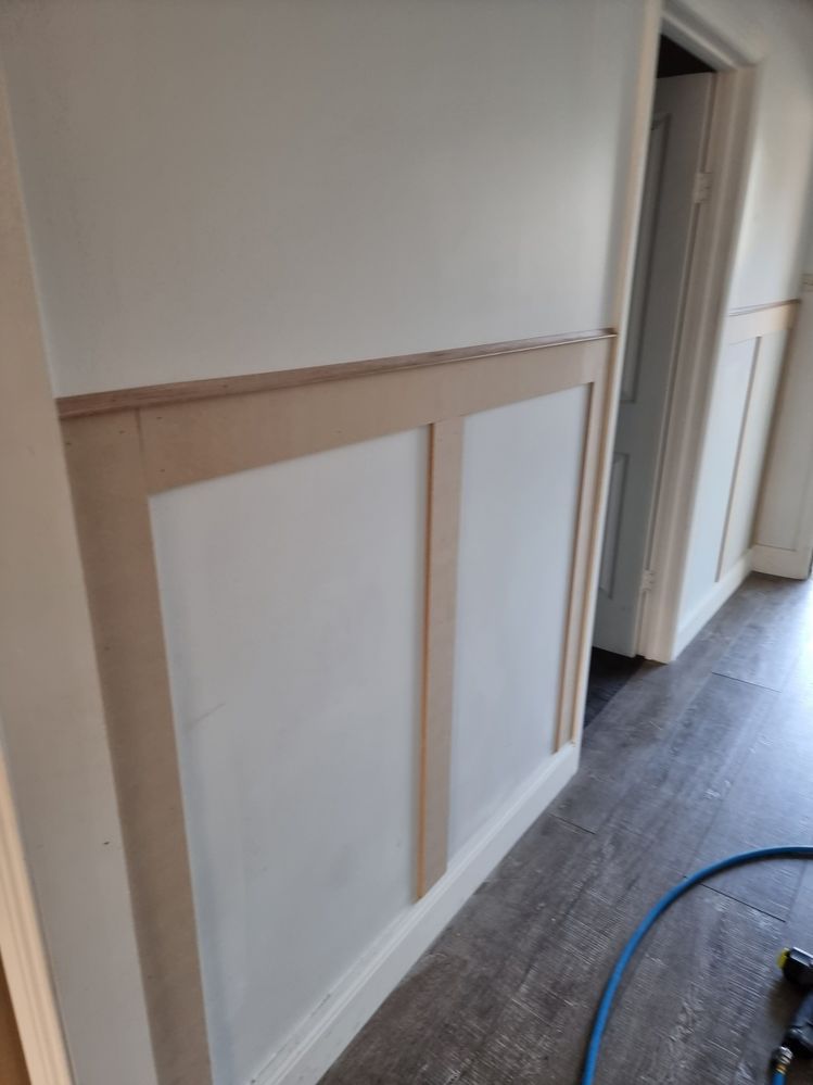

Step 7 - Make it smooth
Fill any nail holes or gaps between the boards with gap filler. Allow it to dry and then sand the patched areas until smooth. Give your boards and trim a light sand to prep for painting. We used 240 grit.

This was a really fun project that we absolutely loved. The next step is to replace the shelf with one that doesn't stick out so much, add a bench seat, and then onto relocating the electrical box and replacing with a nice side light window.

Oh thats a WIN! I was just staring at the blank alcove with my head off thinking about stuff and then I scrolled... and reveresed and scrolled again!
Absolutly love it!, Right down to the door (how did you fill the lines or ??) and the new light you have! The foyer as it deserves to be calle now really suits the space.

@Dave-1 the door came with the house (lucky I know) and the light I got second hand. We love our entrance and we have yet to make our bench seat but it will come.
