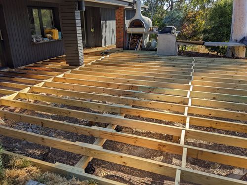

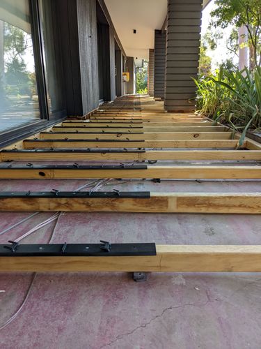

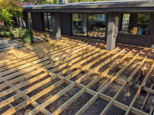

Subfloor completed and have begun to lay the decktec joist protection/board laying system. It's a huge deck, 106m2 to be exact, might take a while to lay. Using 135mm spotted gum with 12g square drive screws.
