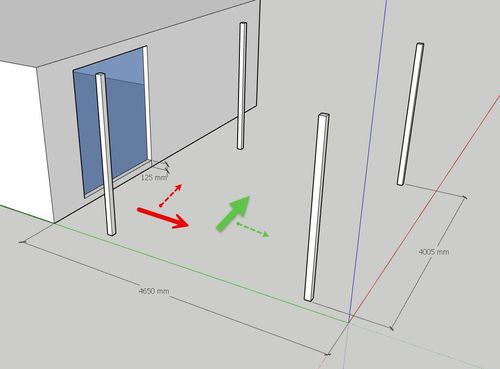

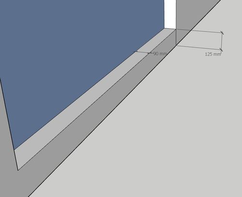

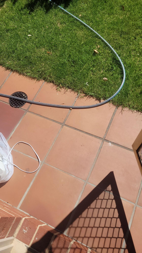

OK, so I've been tasked by my sister to have a floating deck built over existing pavers.  She was suitably impressed that me, an IT pro, could be capable of constructing my own deck that could rival a seasoned tradesperson.
Below is a rough plan of what I have to play with.  The 4 posts are an existing pergola that will remain, so I have to work around those.  The base itself is as per the bottom photo, pavers that have been grouted.  There is a 125mm step down from the door, down to the pavers, which doesn't leave a heap of room to play with.
The first thing I guess I need to decide is the orientation of the joists and the boards.  Which option would be better?  Joists (solid RED) running back to front and boards (dotted RED) running left to right?  Or joists (solid GREEN) running left to right and boards (dotted GREEN) front to back?
Point to note: I don't think those pergola posts are 100% lined up.  The distance between the posts closest to the house are different to the distance between the 2 posts furthest from the house (by around 150mm).

Hi @IronStan001,
There's not much difference in which way you decide to run your boards and joists. That's more personal preference and whether the lengths of decking are available to suit. In a single span, you have 5.7m lengths, so you can run the decking in either direction. One school of thought is that the decking should be run in the green direction as it flows better from inside to out.

One of my issues is that the posts are not 100% in-line.  The 2 posts closest to the house are about 150mm further apart than the 2 posts at the other end, which could make laying the joists or the boards tricky.  However, I do agree that the boards along the green axis (perpendicular to the door) so it could make the deck look longer than it is.
Assuming I run the boards lengthwise, should I fix the first joist/ledger board to the brick?

Working around the posts will pose some issues, but none that will inhibit installation @IronStan001.
My only concern with having the boards like that is that from inside, you'll see the ends of the boards, and that won't look great. You might like to start them 90mm from that inside edge and run a single board perpendicular to their ends so it looks neater.
Re: Deck over pavers using pedestals
The ends of the board won't be an issue, they'll butt up against the frame of the aluminium sliding door.
Hi @IronStan001,
There shouldn't be any issues running the boards straight into the sliding door frame, but you will need to leave a small gap for the boards to expand and contract. Merbau, for example, should have a 3-4mm gap.
