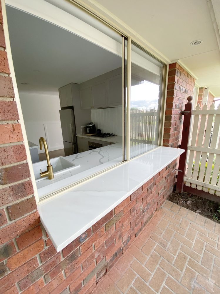

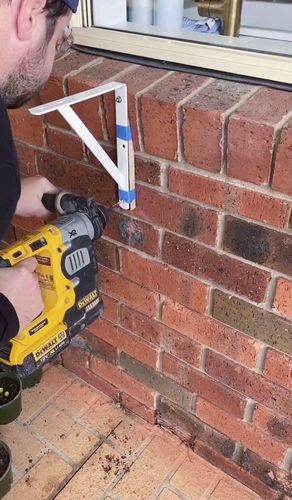

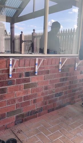

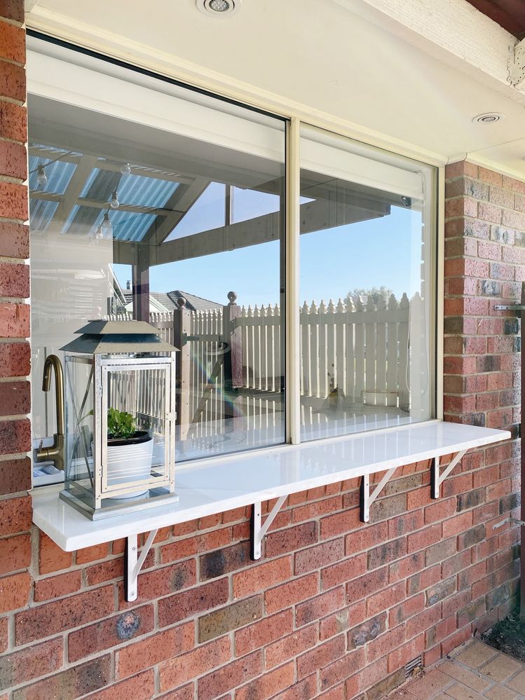

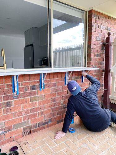

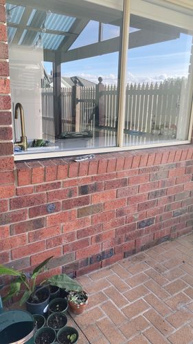

We set out to clean up the pergola area and utilise the space under the kitchen window. It was previously where we kept the rubbish bin, bags of potting mix and gardening tools. We had a spare piece of marble and decided to make our own DIY version of a servery/serving bench. We didn't want to splash out on a new gas strut window, so we worked with what was already there. We removed the fly screen on the existing kitchen window so that when the window is open, food/drinks etc. can be passed through or placed on the servery top.
The project only cost us $26.56 which was the cost of the 4 brackets from Bunnings (Carinya 200 x 250 x 25 x 3.5mm Stayed Straight Bracket) as we already had the existing stone, timber for the wedges and silicone to secure the stone to the brackets.
The project only took a couple of hours to complete and I can imagine you could also recreate the same DIY servery with a timber benchtop.
AFTER: Finished servery
