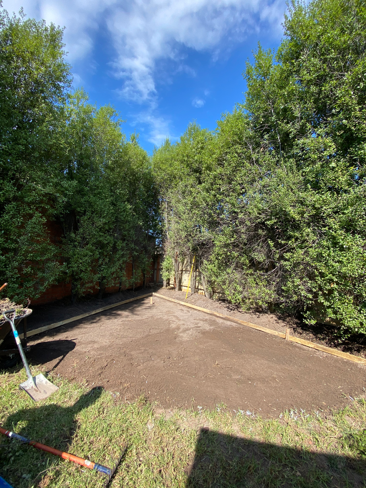

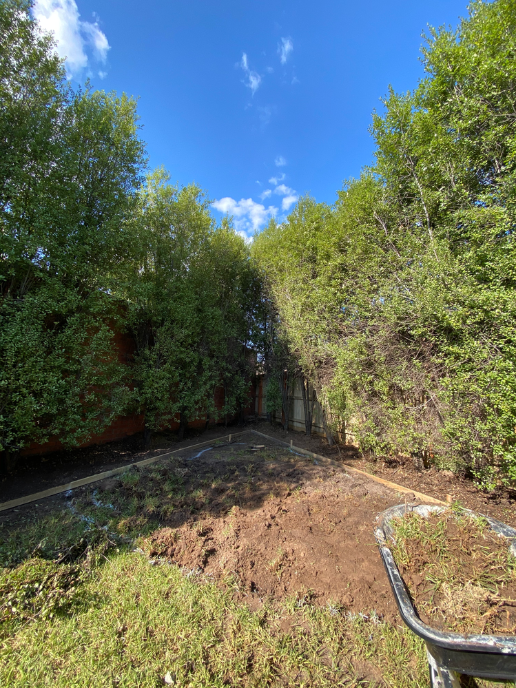

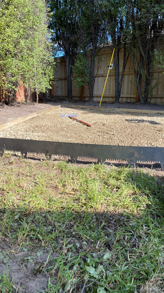

- Started with digging out all the soil and grass to get a level and clean soil surface.
- Raked and levelled the ground.
- Rented a compacter from Bunnings and compacted the native soil.

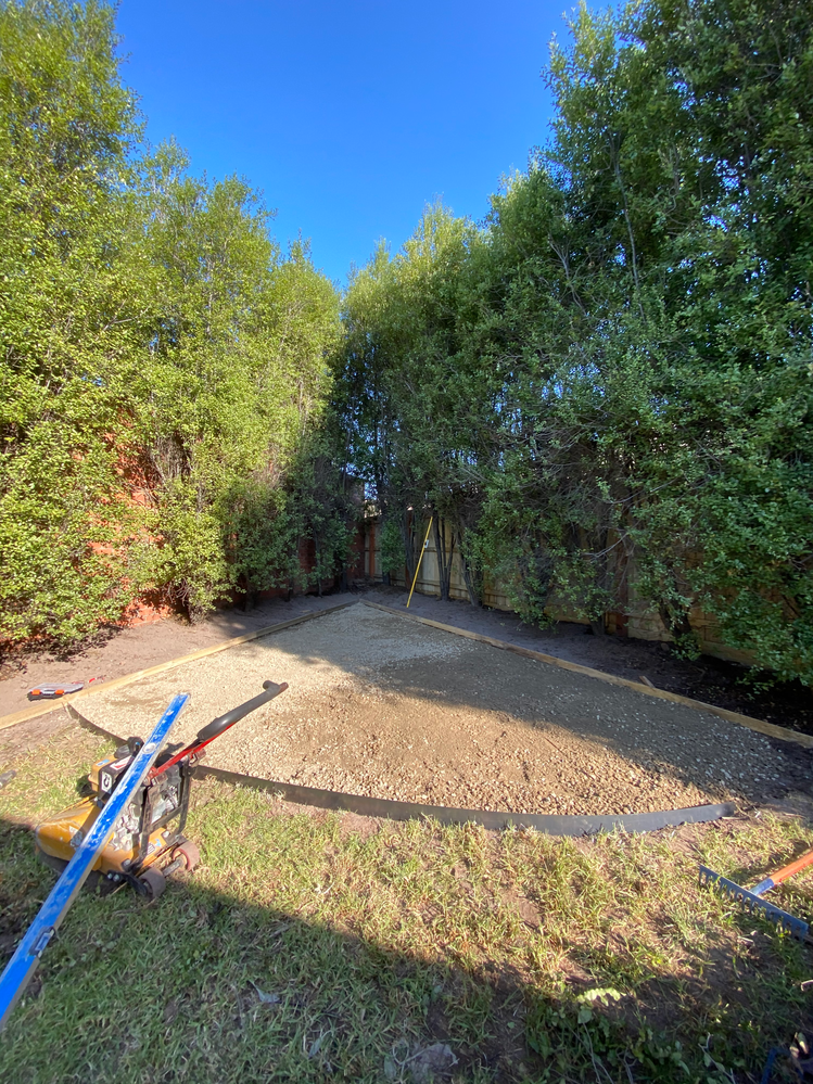

- Installed the Corten steel edging for the area. The Corten will naturally weather with a rust-look. (Purchased from a local steel fabricator)

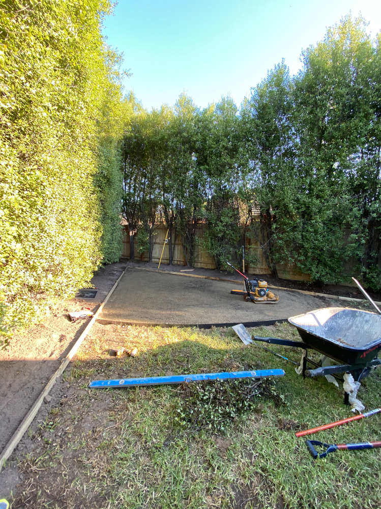

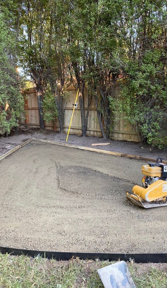

- Wheel barrowed in 3 tonne of road base/crushed rock (ordered from local garden supplier). The two of us simultaneously shovelled each wheelbarrow load, raked and spread it. I think this was the most physically painful and tiring job of our whole house reno!

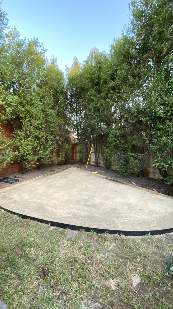

- Used the compactor to compact the road base. This took around 4 passes of the area and 2 hours of compacting to achieve a flat surface.

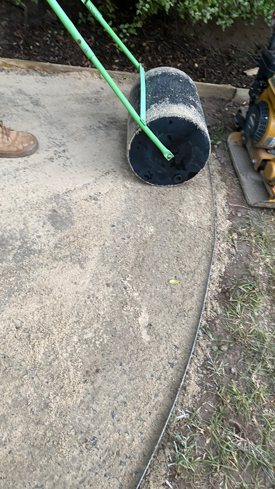

- Spread sand over the whole compacted road base and rolled over with a turf roller. (Bastion 20kg River Sand from Bunnings)

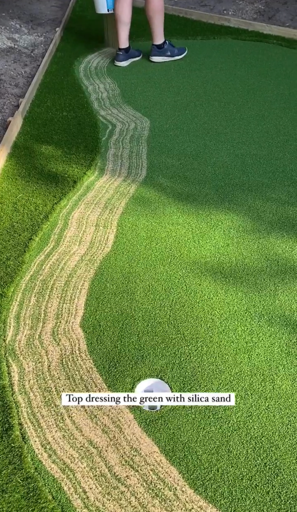

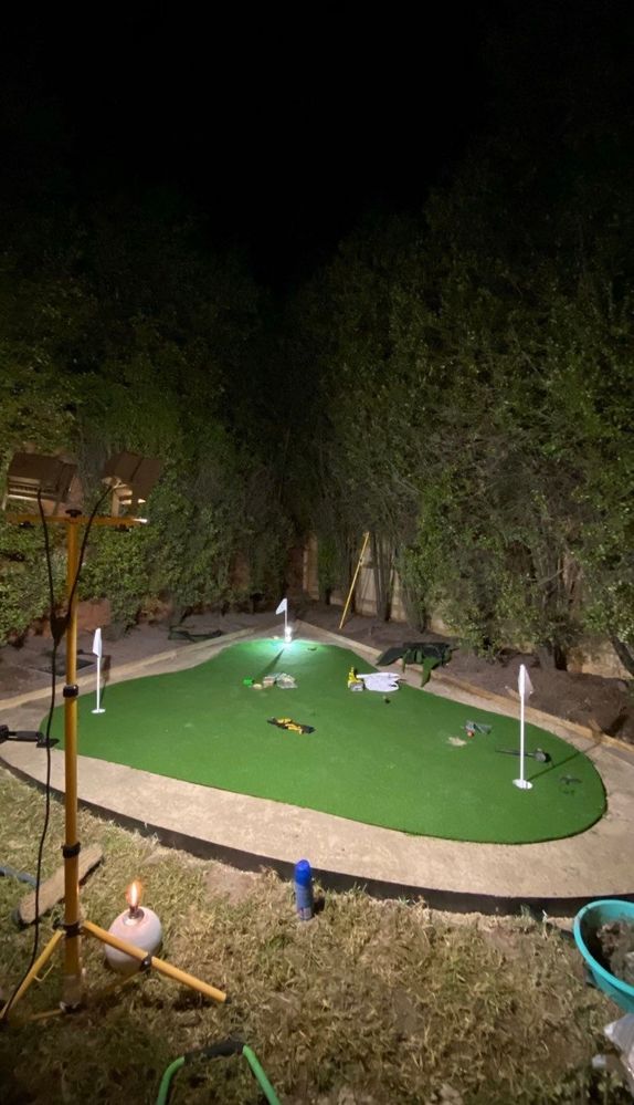

- Top dressed the putting green with silica sand.
- Ran the wiring and installed 8 'Holman Garden Spotlights from Bunnings' around edging under the Pittosporum trees.

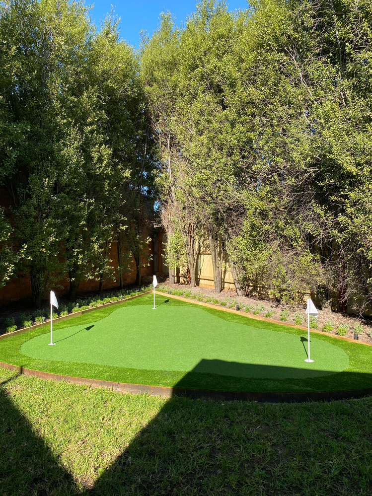

Excellent result. I was impressed by the amount of planned detailed work you put in, including (very sensibly) doing the research first. And now you get to enjoy using that corner, day or night.

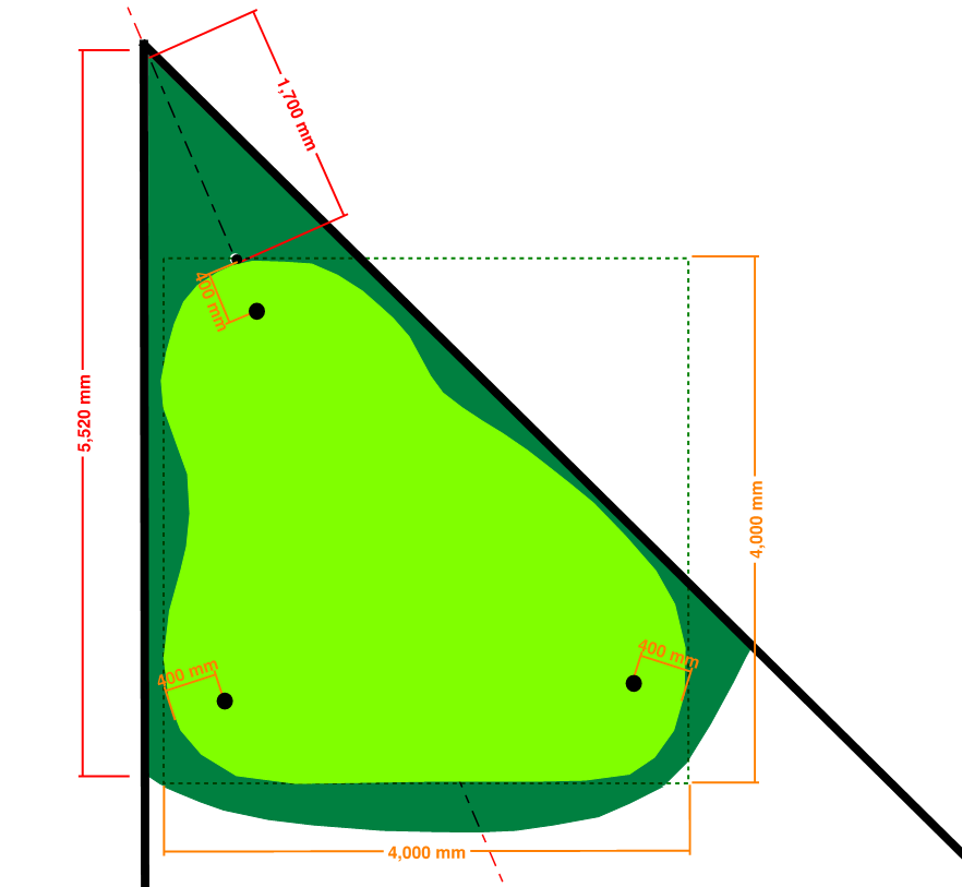

Thank you very much for sharing pictures and the steps you took to build this fantastic putting green. Among the projects you've shared, this is the one I'm very keen to have a go at. What is the overall size of the putting green and what kind of budget would you set aside for this kind of project?

Impressive!

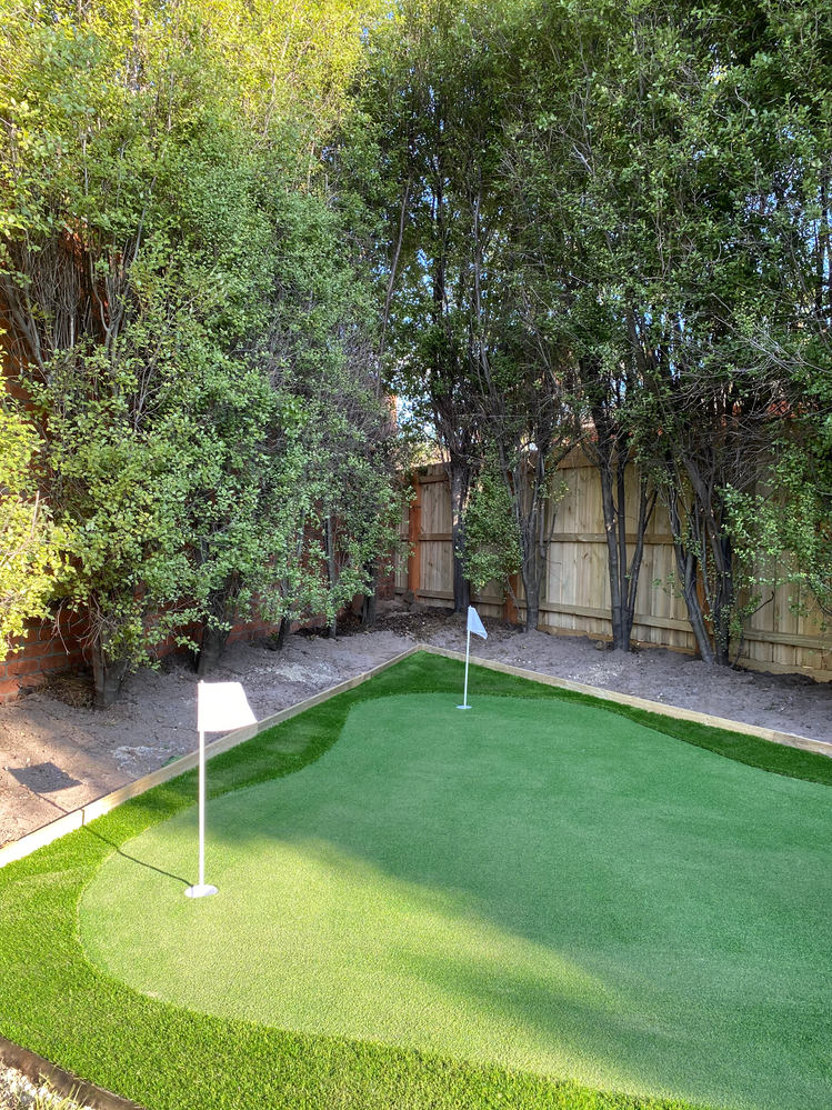

Could be my eyes or the camera angle - but is there a steep slope down to the green?
I like the 'Corten steel edging' with the serrated bottom - haven't seen that before...
Re: DIY backyard golf putting green
Thank you @EricL, we budgeted $1500 for the project and here is a photo of the size/dimensions of the putting green.
Thanks for your comment @Noyade!
No there is no slope down - it might just be the camera angle. Originally the far corner of the triangle area was higher but we dug out about 2 cubic metres of soil to level it out with the rest of the backyard.
