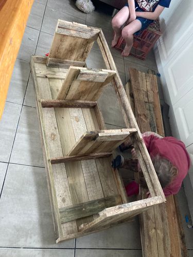

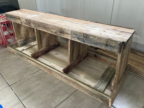

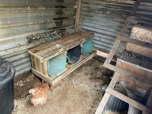

I used 100mm wide pine and 75mm wide pine slats to build this.
4 x 100mm for the base, with the 75mm cut to length for joining the 100mm pieces.
I kept the dividers and lift off lid shorter to allow air flow around/behind the Flexi tubs. I made a lift off lid to easily put in and remove the Flexi tubs for cleaning, but a snug fit to hold them in place.
the lid is basically a narrower version of the base.
this was my first time building something so I’m very happy with the result.
