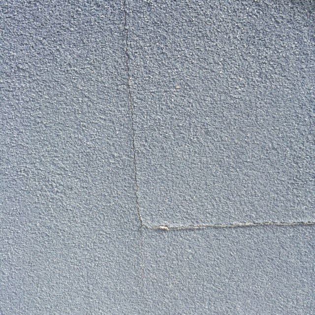

I was looking at the render on the side of the house over the weekend and thinking that it might be time to do something about it. Its an extension done in blueboard and the render has cracked on all of the blueboard joins. Do you think there is any way we can patch it or do we have to go the expensive route and pull off all the blueboard off the house and clad it again?

Looks like there wasn't allowance for the boards to move. The reasonably dark render colour probably doesn't help with the movement - especially if they cop plenty of sun. I think you would have to pull them all off and start again. I wouldn't use blueboard but something like Scyon. Can look great.

I would try scratching the loose stuff out and filling the cracks with no more gaps or a similar flexible filler and going over the lot with a textured paint using a roller.

I asked a builder about this recently and he recommended pulling it all down and replacing it.
