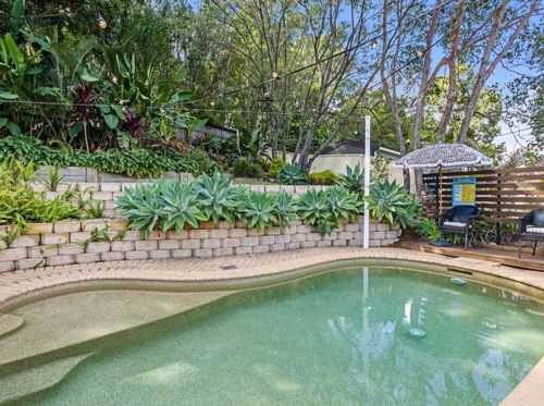

Does anyone know if it’s possible to micro cement over these pavers in my pool area? Is micro cement extremely slippery when wet? Any advice would be appreciated. Thanks!

The frequently asked section of the Dulux Creativo Microcement website states that,
"It is not recommended in swimming pools, baths, splash-backs, exterior horizontal surfaces, or on bench’s near cook tops or wherever prolonged water stagnation is present."
Unfortunately, it doesn't seem like it can be used in this application.

Hi @christinaa16,
Unfortunately, the advice I've received from our suppliers is that microcement is not suitable for this situation as it can only be applied up to 3mm thick.
The gaps between the pavers will not allow the microcement to be applied this thin. This, combined with the potential movement of the pavers makes it unsuitable as a substrate for microcement.
You might like to have a look at the Dulux Concrete & Paving Range as a potential alternative.
