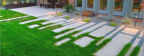

I want to make a garden path kinda like the image, stepping stones between grass. It will lead to the pool.

The previous owners who installed the pool left a heap of the spare outdoor tiles. I know I can't just use tiles like pavers as they are too thin. However could I glue them to the top of cheap 400x400 concrete pavers, almost like a veneer? If so what would I use to secure them? Sorry if this is a ridiculous question... I'm inclined to think it's bot possible as I couldn't find it on google lol

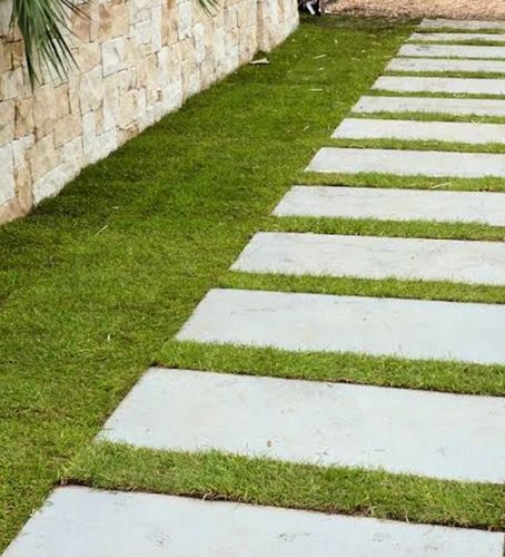

Following on from my previous post. I am planning to use outdoor tiles to create a stepped path similar to the pic.  I was planning to use the tiles as basically a veneer to the paver. However I thought the tiles were 400x400 and would fit on pavers I had. However turns out they are 450×450 and being on a budget I can't just buy bigger pavers.
I am now thinking of making my own pavers/ slabs in situ to put the tiles on. I have a few questions as to how I might do this in the most cost effective way. Note I have zero experience with anything like this so tell me if it sounds to ambitious.
1. Can I use the pavers and some bricks I already  have in the 'slabs' to reduce the amount of concrete I need? E.g if I want a 'step' to be 1x2 tiles (450×900) can I put 2x 400x400 pavers down and just fill the gaps so to speak maybe with a thin layer with mesh or something on top?
2. For the form work, since they are only small slabs and (hopefully already have pavers in there) can I use fence pails and garden stakes as they are cheap. Is there anything cheaper?
3. What concrete mix would you reccomend?
4. If I was feeling super ambitious and wanted to do some thinner steps like pictured, how would one cut ceramic outdoor tiles of this size on a budget? I looked on the website and there is a $40 tile cutter but it looks to be only 300mm. Also how would I make the edge smooth?
Thanks, any advice is greatly appreciated
Re: Grass and tile walkway
Hello @Ona-Budget
Thanks for sharing your question about your tiling project. From an assembly point of view, I recommend building the concrete steps as a single slab with mesh support in it. Using separate parts as a base for the steps opens up the possibility of the base moving separately causing the tiles to split and get damaged. Whereas a single base will stay stable and if it does move, it moves as a whole and not separately.
I believe your idea of using palings for formwork is very economical. My best advice is to use WD40 on the sides to serve as a release agent and will prevent the concrete from sticking to the wood.
As for the concrete, I suggest using Bastion 20kg Premix Concrete or similar. I don't recommend using quick dry as it might cure too quickly and prevent you from getting a level surface.
In regards to cutting the tiles, my only suggestion is to get a cutter that will suite the size of your tile. Another option would be to use a grinder with a tile cutter wheel attached. To smooth out the edges I recommend using QEP Dual Grit Rubbing Stone
