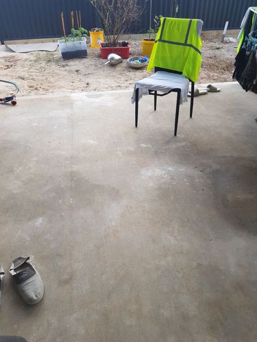

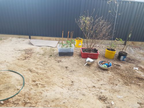

 its 4 mtr flat concrete and 4  mtr or nearly flat soil floor
Hi Guys, I don't have much knowledge about decking and without much handiman knowledge. I wants to build a eko deck in my alfresco and backyard, with the width 4.3 mtr and length 7.5 mtr, my question is is it easy to build deck by buying decking kit from Bunnings?
