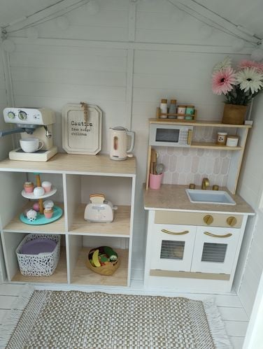

I bought a cubby house kit online, for when my grandchildren visit. I wanted to enclose all of the windows and openings, so that it was waterproof. The kit only had a half door, so I also needed to make it a full door. I used all Bunnings supplies and tools to complete this project. I Love how this turned out!

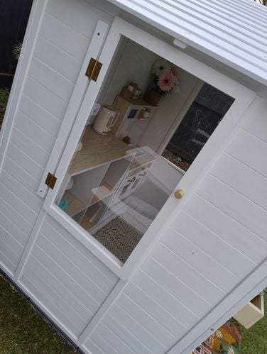

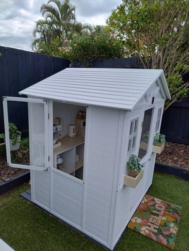

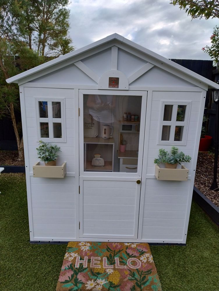

2/4Next I measured the 2 large side windows, and the top of the door I needed to build. Using my mitre saw, I cut all the pine to size, cutting 2 extra pieces for the hinges to attach to on the sides of the cubby. I sanded and painted all those pieces and built the frames using the L brackets (so I would have something for the magnets to stick to). Next, I measured and cut the plexiglass to size, using a metal ruler as a guide and my Stanley knife, and using clear Gorilla glue, I adhered them to the frames, using silicone around the edges to seal the plexiglass. I also cut 2 smaller pieces of plexiglass for the 2 front windows, which I glued directly to the outside frame using gorilla glue. After attaching the windows and the top of the door, I used the multi Seal Foam around the inside frame of the windows. I cut 2 small triangles of pine to adhere the magnets to, at the top and bottom on the front door opening. I added the magnets to the top and bottom of both sides of the cubby for the windows to close. I added knobs to the windows and door.

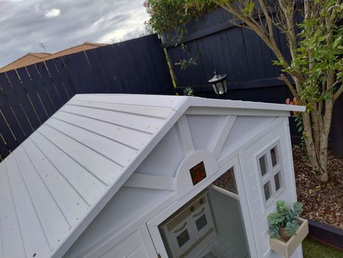

3/4Using the Corflute, I measured and cut 2 triangle pieces for the gable. I used clear gorilla glue to attached them to the inside of the gable frame. I cut the white Gorilla patch & seal tape to waterproof the centre of the roof.

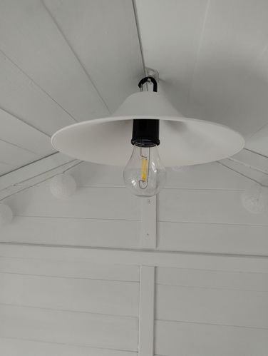

4/4Next I used the camping globe and slipped over the light shade, and attached it to a 3 M removable hook to the ceiling.
This was such a fun project, and the grandkids absolutely love the cubby house.

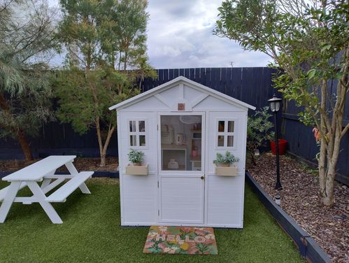

Your attention to detail and the love you’ve poured into every aspect of this project is evident. I can already picture the endless joy and laughter your grandkids will experience as they explore and play in this delightful little haven. The memories they’ll create in the cubby house will be truly priceless, thanks to your incredible effort.
I particularly love the little planter boxes and the "free-range children" sign.
