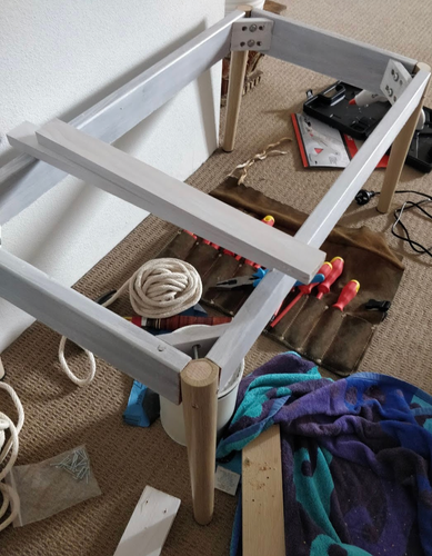

1/3 First I built the frame using things that I already had at home. I took apart an old chair to use the legs of the chair. Then I cut the pieces of timber and screw them to the legs using the corner brackets.
I also added two pieces of timber to the middle to support the bench.

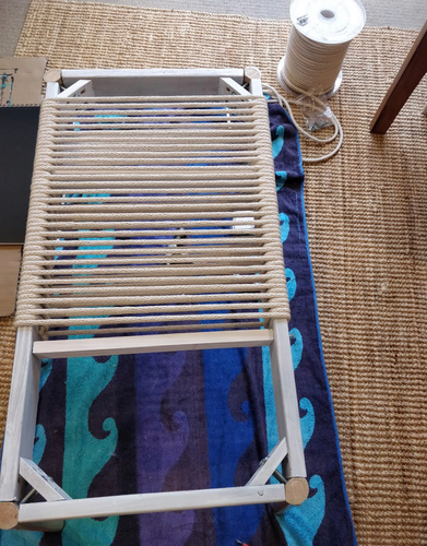

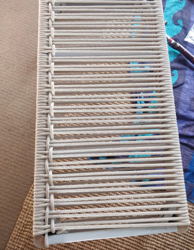

2/3 Then I started wrap the rope around the bench from one end of the bench to the other. When I had to tide knots I made sure the knots were placed underneath so you can not see them.
 And then I wove the rope other way. You can find different ways to do it on YouTube. The rope woven part takes time. Make sure you keep the rope tight and you might need to press the rope closer to each other time to time so there are no big gaps.

Your bench looks good I really like how you have reused parts to make the frame and also the inside supports to stop the sides come in as you wrapped the rope. How long did it take you to do?
Seriously I cant see a bow in the rope with the plant on it! Impressed!

I think the legs will break before the rope gives up.
Building the frame was the easy part but waving took me days. I was only able to do it night time. I don't remember exactly how many days I was doing it sorry.
