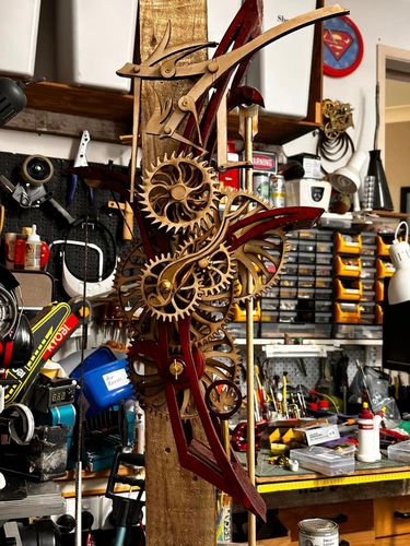

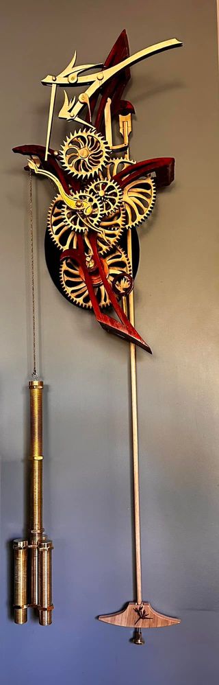

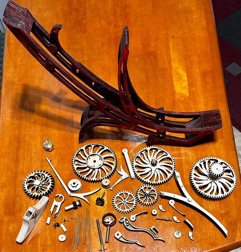

I made this wooden clock from plans I downloaded from the internet.
All the pieces are cut on my Co2 laser cutter, from 3ply from Bunnings
The body I had to cut by hand as it was too big for my laser bed.
It is made from 3ply Pine and Brass, the weight is about 5kg and
is made from plumbing parts and lead.
I used a Cedar stain for the body, and a clear coat on the rest of it.
I started it in September last year and worked on it when I could, mainly on Thursday.
It was a fun build and I am looking forward to the next one.
3Ply pine, brass rods and tube and lead, Sand paper, Cedar stain, and a clear coat
Co2 laser cutter
Scroll saw
Sand paper
Wood glue

ENVIOUS! I have looked at these types of clocks for ages and keep putting the thoughts aside. I would like a laser cutter but the price is always a little too high
You have done a nice job! How close does it run to time? When you say plaumbing parts, are you suggesting we can get all the bits bar the laser cut ones from Bunnings?
As usual, your work is up there
Super... Thanks Dave, The plumbing parts are the brass bits manly the weight and I have to still do a bit of fine tuning with the run time. My laser is just a K40 from ebay and is about $500, but I did some mods that cost about another $300 to $400, but it would be able be used to make this out of the box more or less.
Thank you @Super_D
