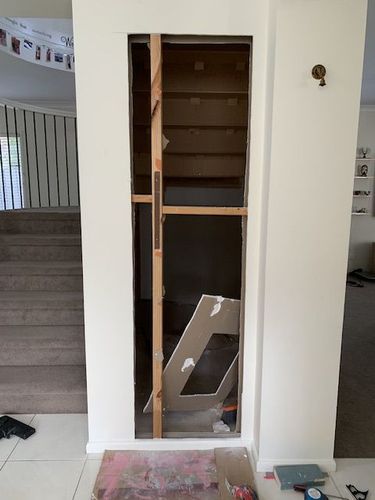

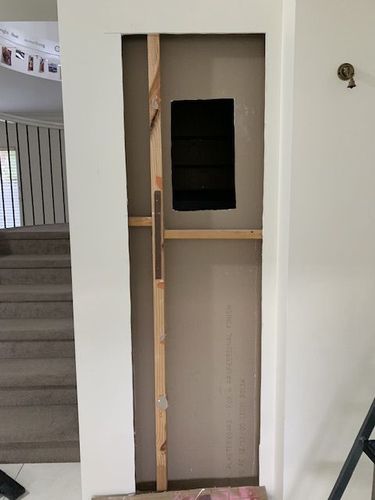

1/6First opened a small area of the plasterboard that I was confident to close in case it turned out to be complex one.
Step 2
2/6Once the small area is opened assess load bearing of the studs and create necessary space to place door frame with structural pine. Double and triple do your math to include door opening, door jamb spaces as needed. Plus add 10 mm to be safe.

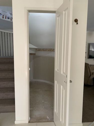

4/6Add door and finish the inside with plasterboard and MDF

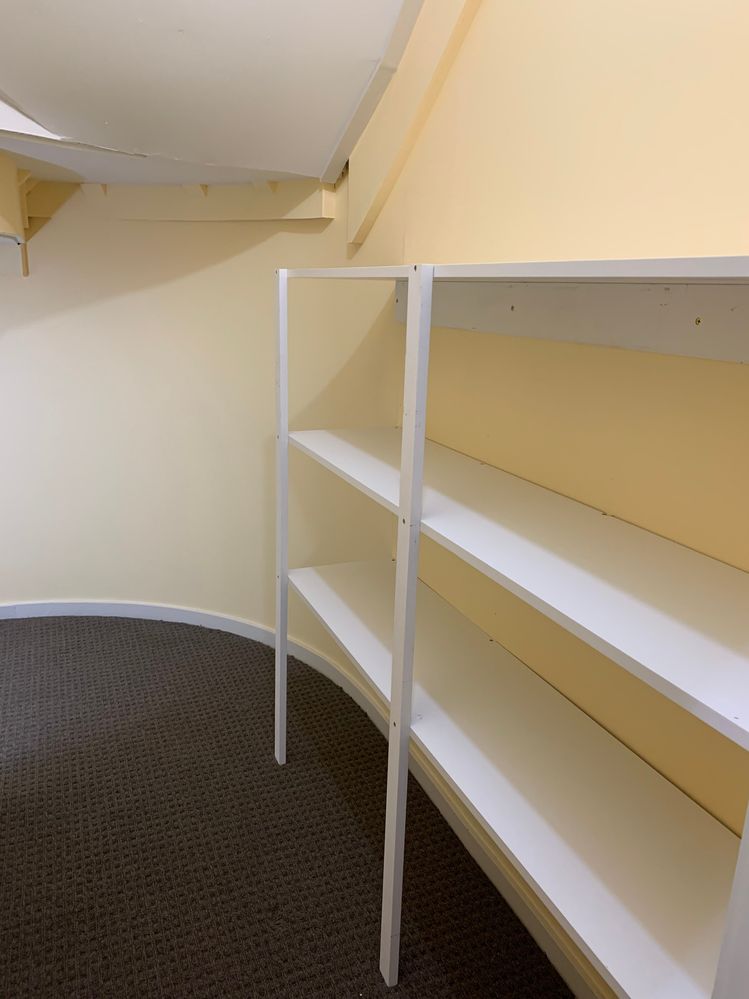

6/6Install smooth edge along the perimeter and lay down carpet. Install shelves.

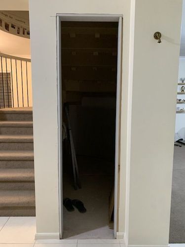

Re: Under Stairs Storage
What a fantastic project and an amazing amount of space that you've taken back, @J-P!
You've done a splendid job, and your attention to detail really shows.
Many thanks for sharing your results.
Re: Under stairs storage
Good afternoon @J-P
Nice way of regaining some space Your door is messing with my spatial awarness tho lol The doorway looks 2/3rds a standard door and the open doorway with the door attached looks like a standard door? How wide is it and did you special order a door? (I have a door in my sunroom that is smaller then normal and have even considered moving the wall just to make it the same!
I do think its a trick of my eyes tho.
You have eagle eyes. It is a 520. Got it via special order. I would have had to realign 2 studs if I needed 620 door. So didn’t go down that route.
