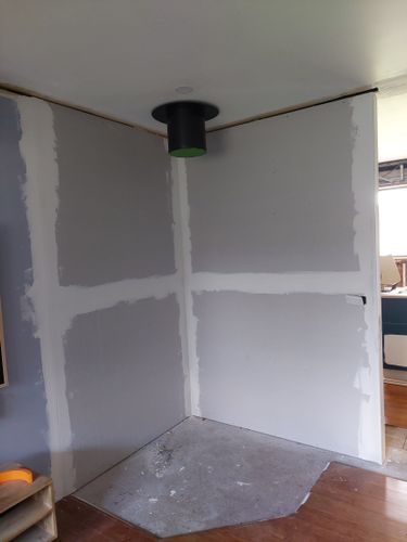

Hi there @MitchellMc
Can i tile directly onto gyprock with a mosaic style stone tile for behind a fireplace or does it need a 6mm villa board/cement sheet first?
Ive found it qite hard to get a copy of the aus/nz wood burner standards.
Any help would be appreciated.
Re: Tiling onto gyprock
Welcome to the Bunnings Workshop community @BevanJ. It's marvellous to have you join us, and many thanks for your question about fireplaces.
Different models of fireplaces have different setback requirements. So, it would be best to contact the manufacturer of your fireplace and request the specifics for your unit, as the Australian/New Zealand standards (AS/NZS 2918:2018) need to be purchased. Typically, the supplier will put together a mini guide/summary of the code to make installation easy. It might have points like the hearth must be of non-combustible material and extend 30cm from the front door, or combustible wall linings within the set-back zone must have a non-combustible covering such as tiles. Those are just made up just to illustrate. If you call the company, which is what I normally do, they'll most likely be able to answer your question. Let me know if it's one of our heaters, and I'd be more than happy to do so for you.
I'd recommend you consult with a certified wood heater installer, the wood heater manufacturer and your local council to determine the installation requirements in your area.
