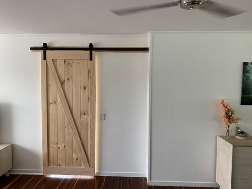

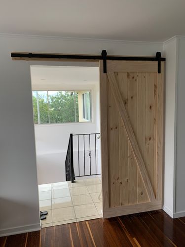

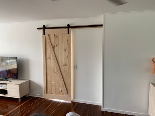

Recently completed a sliding barn door. This was needed to shield our living room from the harsh Afternoon sun, beaming in through western facing windows. The door also helps to partition the living area from the front stairs and helps the air conditioners run more efficiently.
This project was completed using 7 pine lining boards and lengths of 89x19mm and 140 x 19mm dressed pine.
The door track kit is a rolltrak barn door system.
A dressed pine headboard was used to secure the door track to the studs in the wall as the pre drilled holes in the track did not quite line up with the studs when the track was in position.

I like how the pine used for the rail looks like it’s part of the whole setup and not something that was done to fix a problem.
I’m gonna use this design.
Where did you get the rail kit?

how much clearance do you have from the wall the to inside or the door? Will it clear a switch on the wall which is 40mm thick ?

This looks great. May I ask what product the lining boards were please?

Let me tag @Jwyatt to make them aware of your kind words and question. The store carries the 140 x 12mm 4.8m Unprimed Solid 321 Lining Board and it might be the one that they used. As for the rest of the materials they used 89 x 19mm and 140 x 19mm dressed pine.
