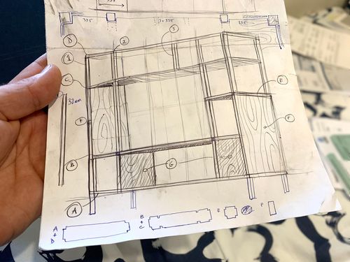

I started out like I always do, with some online research and some sketching. Drawing the unit helps me to plan out all the various pieces of timber I'd need, and how they would come together.
Initial sketch of the unitInitial sketch of the unit

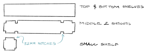

Working out the different shelves neededWorking out the different shelves needed

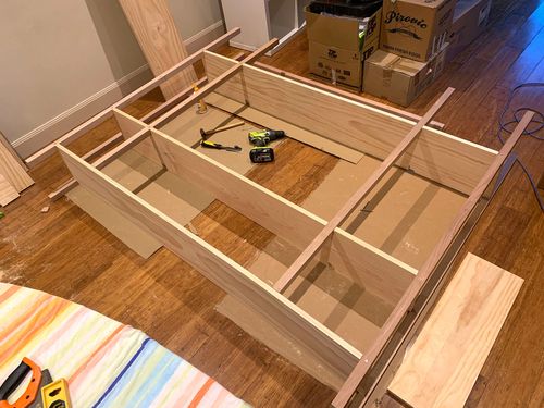

Construction was super simple, with wood glue and counter-sunk filled generously-long wood screws. I started with the shelves, cutting out all the 32mm x 32mm notches, and then worked on one side (below), before flipping the unit over and working on the other side. The edge pieces helped to keep the whole thing square. As I built this, I realised that it would need a middle set of feet, which I made from cuts of the 32mm x 32mm posts.

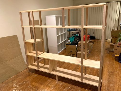

The finished unit, wood filler as yet unsandedThe finished unit, wood filler as yet unsanded

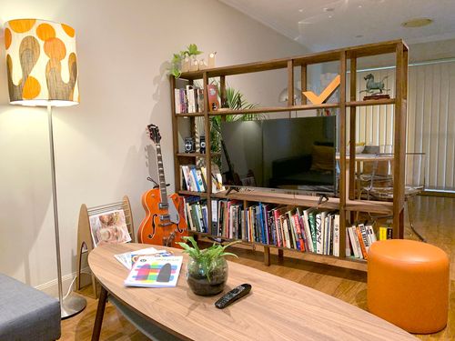

I decided to stain this puppy in a cedar stain (Cabot's), to unite the different colours of the two timber types as one. Cedar is pretty dark, as you can see, and this unit might look better with a much lighter stain.
The finished unit, after being stained with Cabot's cedar stainThe finished unit, after being stained with Cabot's cedar stain

One tip I've learned along the way about making your own furniture is that it's totally OK to design it around some stuff you already have, e.g. books that are overly tall, or storage boxes of a certain width. Also, working up the design based on a simple grid can help. You can see just the bottom of a sketch in the second photo, where I'd done a grid where each side and height was ~330mm. Have fun with it!
