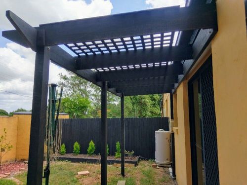

The afternoon summer sun heats up the bedroom and ensuite.The afternoon summer sun heats up the bedroom and ensuite.
I would like to build a basic timber pergola over the front courtyard that faces west and put shade cloth over the first metre out from the bedroom and ensuite.
Do you think that would be enough to cut the sun heating up these rooms?
Any other suggestions ideas appreciated.
There is currently an aluminum awning over the bedroom sliding glass door but this does not seem to cut down any heat in the room.
Thanks
Re: The afternoon summer sun heats up the bedroom and ensuite.
Hi @Former Workshop member ,

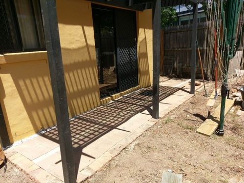

The sliding doors already had window tint on them but may not have been the best ones for keeping out the heat. I ended up building a pergola over the area and it does cut the heat down considerably. I'm also training some climbing roses over the top. The drought and 40 degree days has put it to the test recently and I'm glad I did it.
