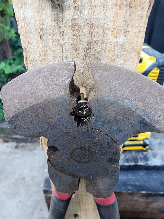

"WD40 and a pair of pliers"
You have a lotta screw head showing.
I just performed some 'live trials' with an old speed wrench and fencing pliers.
Fencing pliers hands down the winner - tremendous crushing force and then turn.
If you try this and the screw fractures - then you were never gonna get it out.
Keep us informed!
Cheers!
