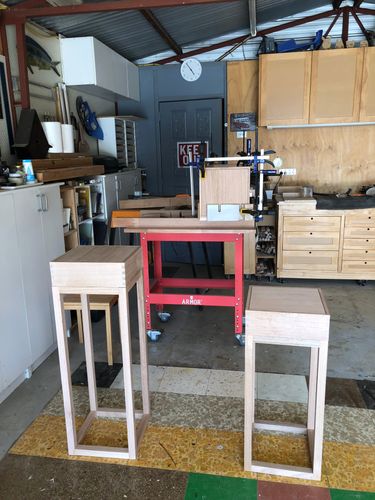

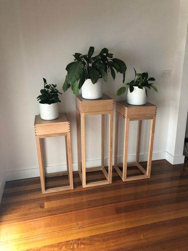

I made these new pot plant stands using Tasmanian Oak timber.
Material used.
32mm x 32mm Tas oak.
110mm x 12mm  Tas oak.
Home made floating tenons to suit mortises.
Plastic angle brackets and screws.
Wood glue (Titebond 1)
Water based satin clear varnish
Plastic feet floor protectors.

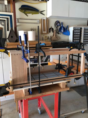

I have been wanting to make these stands for the last six months, after looking at different ideas on line, I decided to go with this style.
If you put your mind to make something, it's very rewarding when you see the finished product.
All joints are glued.

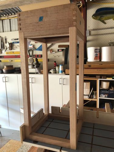

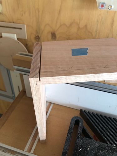

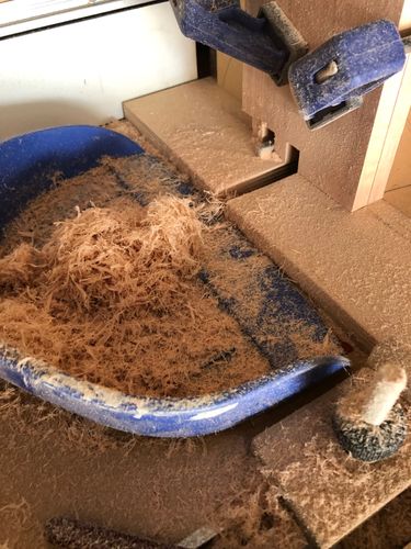

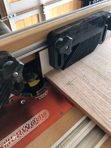

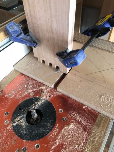

The legs are made using floating mortise joints. I used a horizontal home made router table.

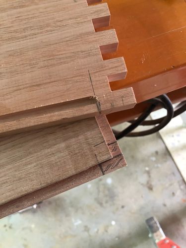

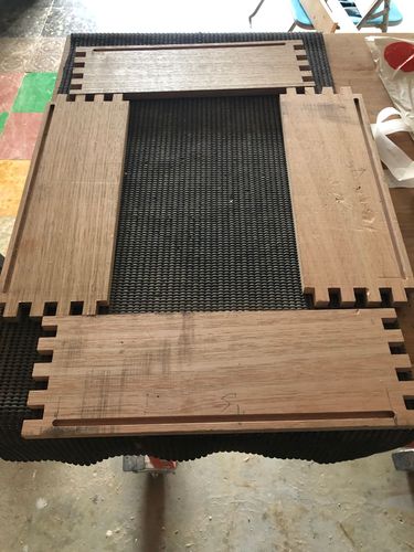

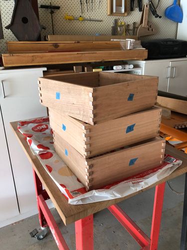

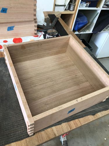

The top box section was made using  box joint jig, I also made the jig to do this process.

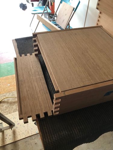

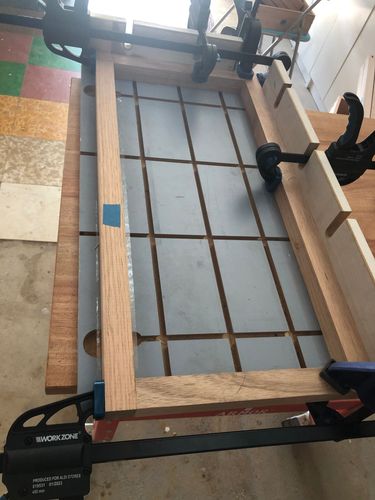

For the top part, where the pots sit, I glued three pieces of 11mm x12mm tas oak, recessed to give a shadow line and recessed to mount into the box section of the planter stand.
The top base wasn't glued, it was just fitted into the slots and held together by just gluing the box joints.

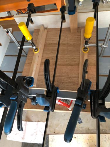

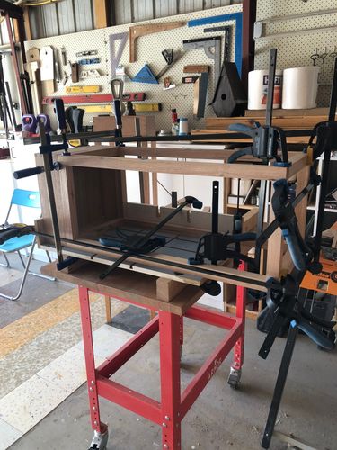

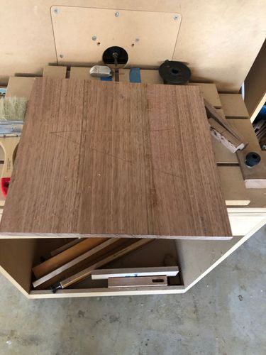

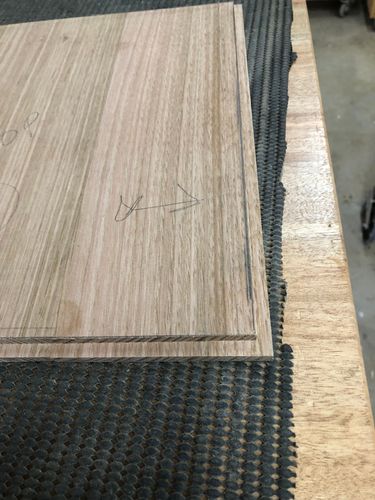

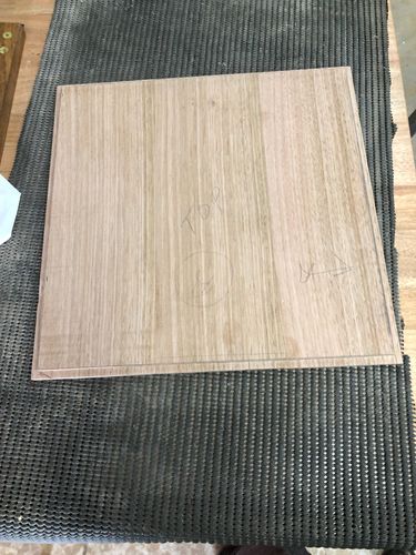

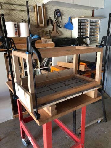

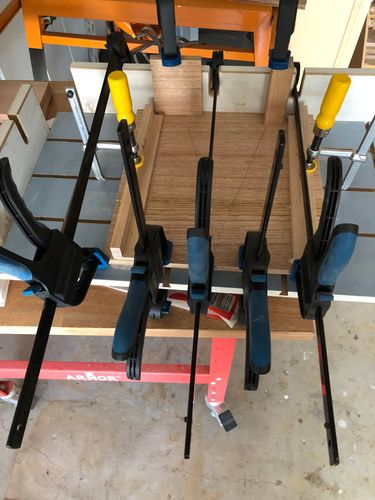

Here are more photos of the work done to complete these planter stands.

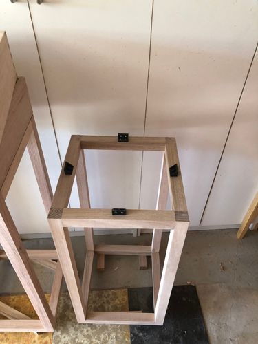

I only needed 3 of the stands, I started by making one as a prototype, the assemble of this one was by using plastic brackets for the top base of the stand, which was difficult to line up, so for the next tree stands I re designed the top section, with slots, no brackets required.
IMG_7055.JPG IMG_7056.JPG IMG_7058.JPG IMG_7059.JPG IMG_7071.JPG IMG_7077.JPG IMG_7079.JPG IMG_7080.JPG IMG_7084.JPG IMG_7085 - Copy.JPG IMG_7086.JPG IMG_7088.JPG IMG_7090.JPG IMG_7091.JPG IMG_7094.JPG IMG_7095.JPG IMG_7096.JPG IMG_7097.JPG IMG_7099.JPG IMG_7140.JPG IMG_7144.JPG IMG_7145.JPG IMG_7146.JPG IMG_7147.JPG IMG_7153.JPG IMG_7154.JPG IMG_7155.JPG IMG_7162.JPG IMG_7163.JPG IMG_7176.JPG

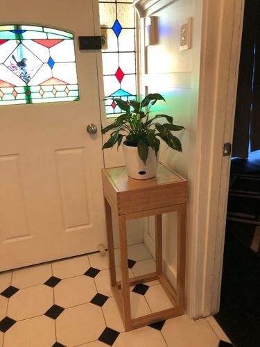

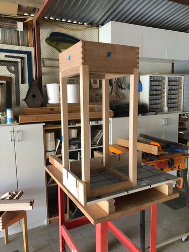

This stand was the first prototype one of the four stands I made.
This is how I joined the top to the sides of the orginal/prototype planter stand
This was my original and first try at making a planter stand.
