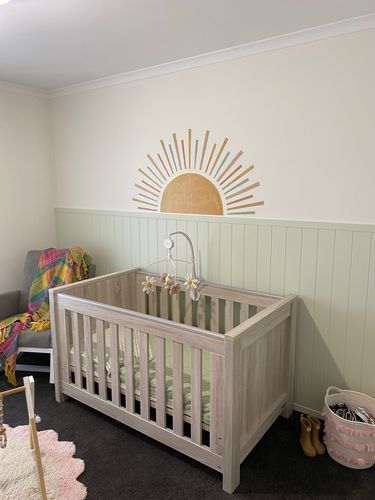

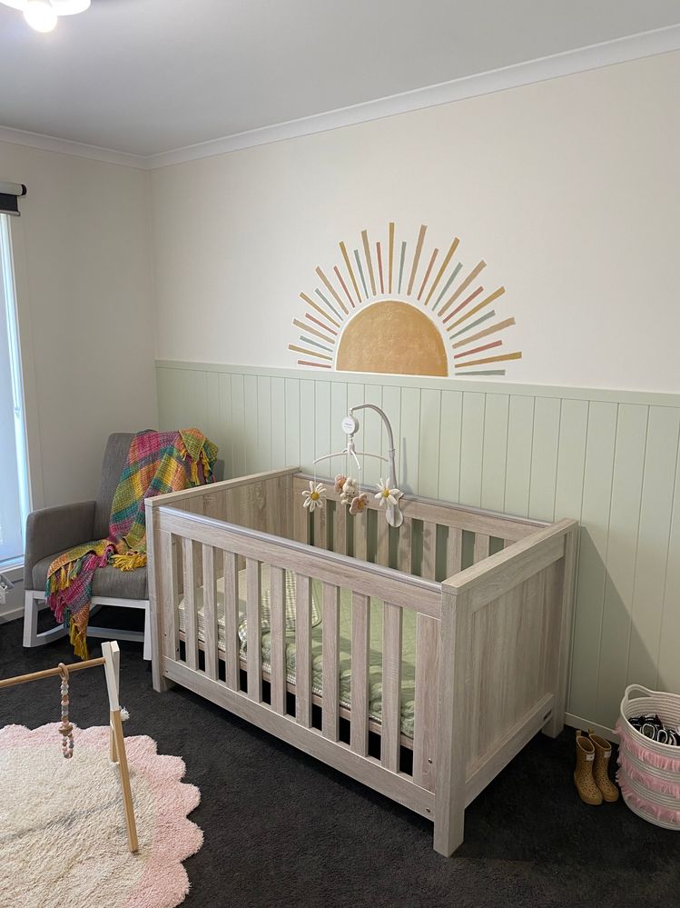

We used the easycraft VJ wall lining to add a feature wall to our newborn daughters nursery, we completed the look with a lick of British Paints - spearmint crush 399 paint and a Bunnings sun wall decal.

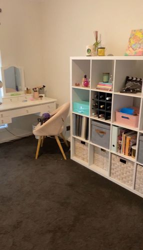

Before :
After :

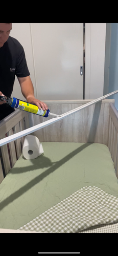

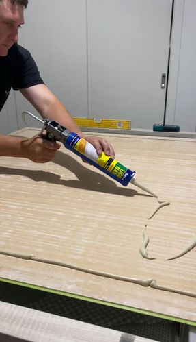

We used liquid nails and screws to secure the panel to the wall making sure to screw into the wall studs.

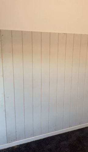

We then filled all the screws holes and placed a boarder along the top to finish it off neatly.

We used British Paints spearmint crush 399 for the colour. We primed the wall with paint primer and then did two coats of colour.
Step 5
To finish it off we added a wall decal we found in the paint section. (I can’t find the link to it).
