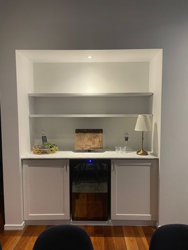

Hi there I have built this but stuck on what to put above. OPtions are
Arch with shelves
Cupboard with glass doors on one side then shelves
BUT we really want a wine rack in there but no idea how to include it or build it, would love any inspo please.

hi Eric thanks for your help so far.
ive gone with the shelves albeit cut them a bit short but hey the arch will cover it.
my space is 1760 x 810 what’s the best way to cut an arch to fit this space? Love any advice thank you

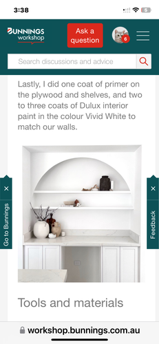

Struggling to understand how to draw the arch?! So it looks like this

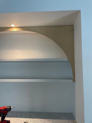

Thanks so much I’ve managed it BUT made a mistake on the length! How can I correct it?
