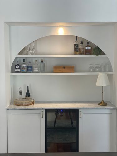

Need inspiration for dry bar area
Hi there I have built this but stuck on what to put above. OPtions are
Arch with shelves
Cupboard with glass doors on one side then shelves
BUT we really want a wine rack in there but no idea how to include it or build it, would love any inspo please.
Thank you

finished thank you to everyone who helped me achieve this! Really pleased

Great job @Jersey1975!
It's come up wonderfully and I'm so glad I could help.
Thank you for sharing the finished project.
Re: Dry bar inspiration!
Evening @Jersey1975
Now thats a solid effort! It looks great!
Stylish and looks like what you described from the beginning!
Any things you would change/note if someone else was thinking of a similar project? And Is there any chance of you putting a project together to show your steps?
