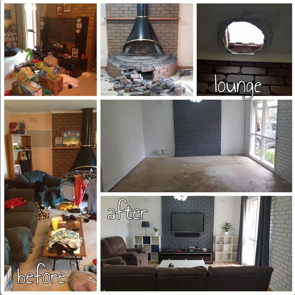

We never used the fireplace, it was just too much hassle, and too smokey.  It only came in handy at Christmas time to hang stockings... so one day I got the hammer drill out and there was no going back from there!

I used the hammer drill to drill into the motar of the bricks around the fireplace, starting with the edges and making my way down to the slab.  The bricks and mortar were carted outside to be disposed of, there was a LOT of dust!!!!  Recommend closing all doors to try and keep the dust in one room only.
The piece that was left was a large concrete base, which I left til later to work out what to do with it!

This update has really opened up our living area and brightened it up.  It is so much easier to keep clean now with the laminate flooring and feels a lot more modern with the new colours.  Also, Santa was still able to deliver our presents using a little Christmas magic!
