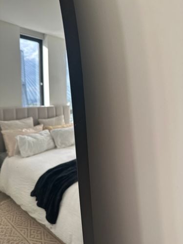

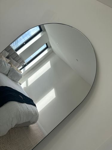

I’m wanting to change the colour of my metal mirror frame from black to gold.
The mirror is near new with no rust or dents on the frame.
What paint would i use for this? aswell as what preparation would i need to do?  i am wanting to avoid spray painting as the mirror is to heavy to move, preferably use a brush and just paint the frame by hand.

I suggest wiping the surface of the metal frame using Selleys Sugar Soap Wall Cleaning Wipes - 25 Pack. To prevent accidental overpainting on the mirror, I recommend covering the mirror edge with ScotchBlue 24mm x 55m Sharp Lines Multi-Surface Painter’s Masking Tape - 24mm. Once the surface of the steel frame is dry, I suggest painting the surface with Dulux 1L PRECISION White Maximum Strength Adhesion Primer for the topcoat I propose Porter's Paints 100ml Metallic Antique Gold Furniture Paint.
My best advice is to purchase the best brush your budget can afford and make sure to give each coat enough time to cure before painting over it. Once the paint is totally dry you can then remove the masking tape from the mirror.
