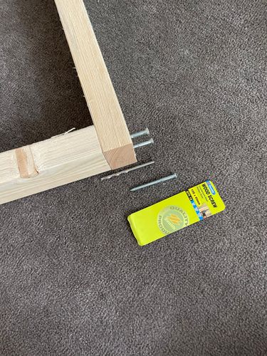

Well, I've successfully used a circular saw for the first time haha, and have some nicely cut timber! However, I'm now stumped with the screws.
I bought timber screws, enough to embed maybe 15-20mm in the wood, and drilled a long and decent-sized pilot hole, but my screws are getting stuck (I think as they meet the second bit of timber), and now they won't budge in any direction. (I also glued the wood together beforehand).
Would you be able to steer me in the right direction? Am I missing something really obvious here?

Hello @katep1
If your screws keep getting stuck it might be necessary to use the next size up in regards to the drill bit. Please keep in mind that the drill bit must not be bigger than the body of the screw otherwise it will not anchor properly. Make sure to drill both pieces of wood and drill deeply. Make sure to push the frame to the wall so that you have leverage when screwing into frame.
