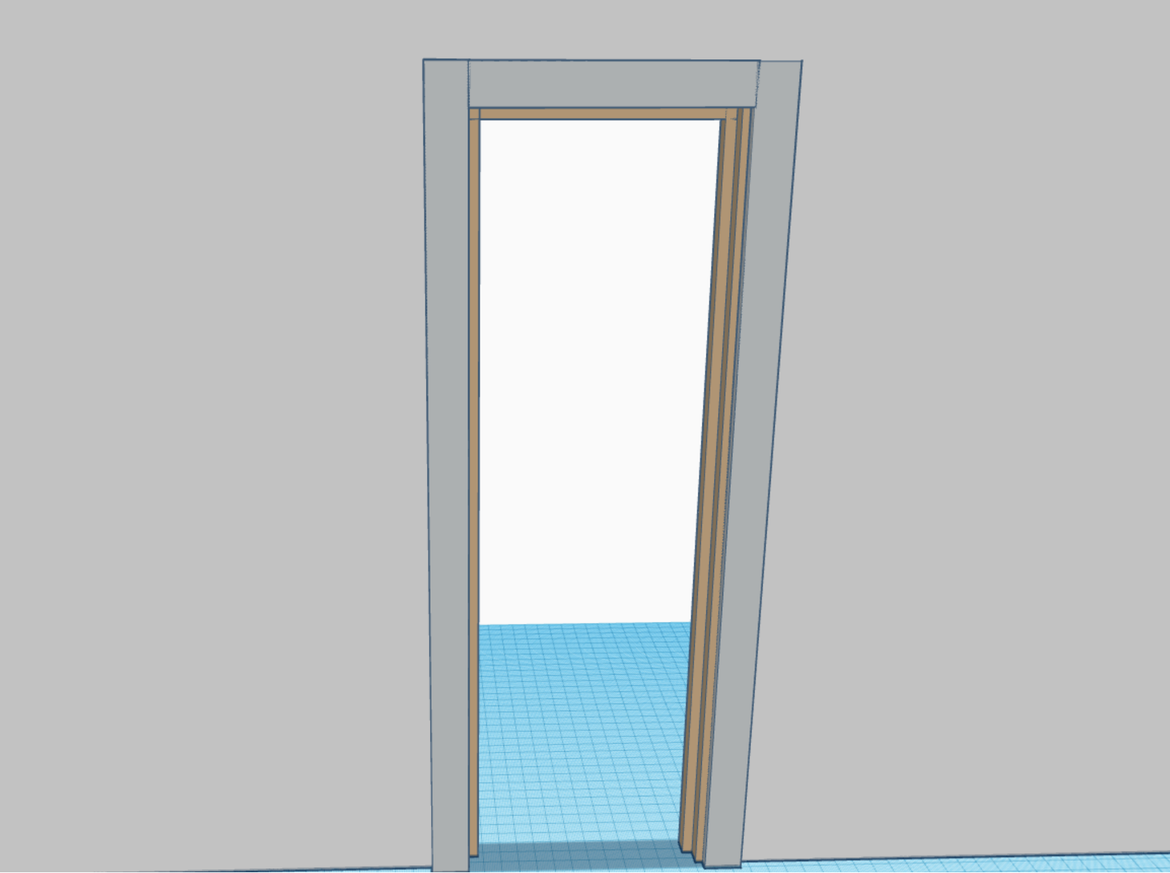

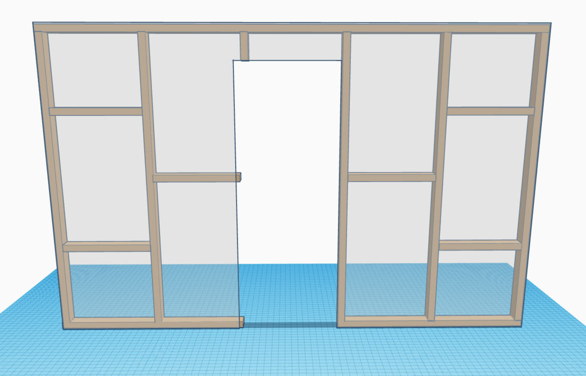

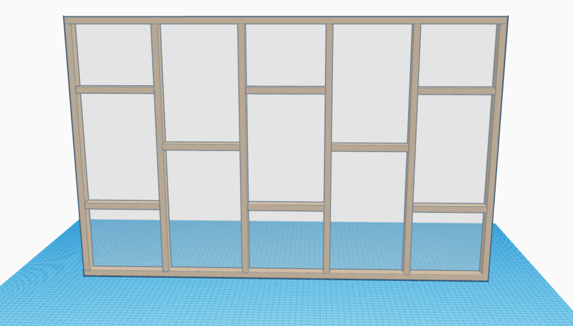

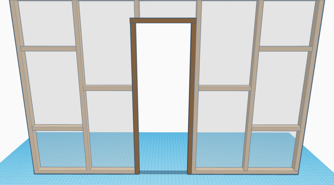

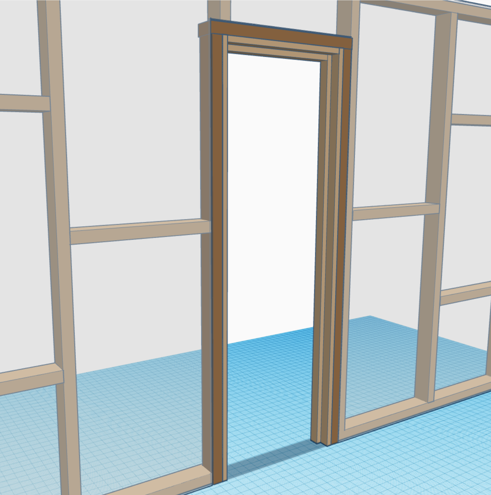

Once you've determined where the door will be placed, you'll need to mark out the area. Allow enough space for the door jamb to be inserted around your door's perimeter. When cutting the area out a reciprocating saw will be the most effective tool for the job. Adjustment of the stud work will be required so there is a stud on either side of the opening and one directly above. These can be screwed into the existing frame. Once the frame is sorted, you can follow this guide on How to install a door jamb. I'll also include the video below. I'm sure you'll also find this guide on How to hang a door useful. All that's left is to install any trims around the door frame to finish and cover exposed plaster edges.
I've created and included some renders below to assist with your project.
